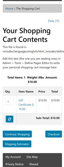

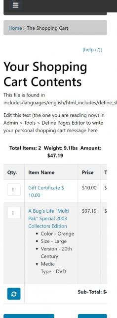

    While on mobile (small screen), the shopping cart table requires scrolling in order to see the "total" column.
    If thesmall screenison landscape,the shopping cart table is displayed/seen in full. It seems to be too big for the small screen in portrait mode.
    Is there away to fix it so there is no scrolling and the table is shown in full?
    I looked at post #211 thru #218 which seems to be similar issue but the fix does not work for me. It is not android or iphone related i believe.

    Can you go to jeandretDOTcom and place an item in the shopping cart while in mobile to see if this matches your look? This is the latest bootstrap with a standard demo load.
    Either that or give us a link we can look at?
    This is a known bug - I brought it up with lat9 when having my site upgraded.
    It only happens when you have an item with attributes in the cart. It is the offset of the attributes causing it on small screens.
    Tested on the above site with "TEST $120 Special $90" on my old Moto E4+
    Attributes cause scrolling. Non attributes don't.
    Same result using Chrome emulator on pc.
    I tried jeandretDOTcom and it is behaving the same way as my site. For reference, my site is royal-fleurDOTcom/upgrade.
    I tried a few different thing on either site.
    While in the shopping cart page:
    - if the product has no attribute, the table (quantity/item name/price/total) is display is display within the "viewport"
    -if the product has attributes, the colum total from the table gets push to the side like out of the "viewport"
    Hope this makes and sorry for the lack of better words to describe it.
    Picture from jeandret site :
    No attributes on product
    With both attribute and no attribute

    Quote Originally Posted by gsh68 View Post
    Thank you for the info. For once, it is not something i messed up :-)
