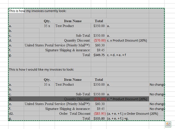

    I would like to be able to discount at the Order Total Level, and have done pretty well with Product Discount, but how do I discount an order at the Grand Total level, including Product and Shipping?

    I'm not sure how convey what I'm looking for, so here's the first pass. Hope this helps, but if not, please let me know what more I need to do to make it more understandable.

    Then how are you getting the Quantity Discounts as a line item on your invoice? Built-in Zen Cart Quantity Discounts reduce the price of a product and do not show up as a line item. Are you using another order total module?

    I am using Modules/Order Total/Quantity Discount. I have set 3 levels of discount and have set the sort order to immediately follow the product total, which is how the discount is based. It works perfectly for my needs, except for the subject of this thread.
    I am about to try your Quantity Discounts module, so I'll let you know how that works for me.

    You are already using my Quantity Discounts module.
    To get to your goal, you'd have to change the logic to add in the shipping discount.
    Then change the sort order of the module so it's at the bottom below Shipping and just above Total.

    How do I do that? what code to I add/change in which php file (s)

    You should be working with a developer. I really can't do this kind of thing on the forum; it's too complicated.
