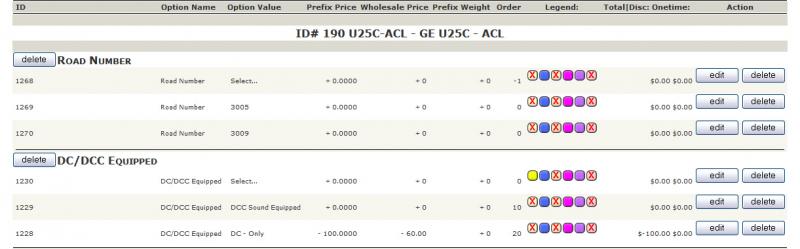

    Hi Jeking, Thanks for getting back to me. When I say "difference" the attribute in question actually reduces the product price so I am using "difference" in the subtraction sense.
    Basically our MSRP customers should see a -100$ shift in the cost of the product when they select "DC Only" whereas the dealers should see -60$ shift in the price.
    This is happening on all of our products, but I am direct linking to one here just to save you some hassle:
    http://www.korea-brass-usa.com/index...roducts_id=190
    You can use this testing pricing bracket 1 username and password to see the effects of the dual pricing mod:
    username: [email protected]
    password: testdealer
    Here is a screen cap of the attributes controller so you can see the pricing setup in there:

    That's not how the wholesale attribute pricing was designed to be used. From the ReadMe:
    2. Attributes can be set in the same way, but you need to enter the prices in the "Trade" field and use comma separation, eg. 50.00,30.00,0.00,25,00
    The field is now labeled "Wholesale Price", just to clarify.
