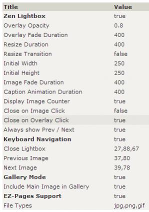

    Quote Originally Posted by DarkAngel View Post
    what are your setting for the lightbox in admin
    Hi DarkAngel - previously "Close on Overlay Click" was set to false, now I changed it to true and at least can close the lightbox by clicking outside of it. I tried setting "Include Main Image in Gallery" to false, but instead of eliminating the bogus image on EZ Pages, it broke the display on product pages, so I set it back to true. What other change(s) would you suggest? Thank you! ~ Magz
  4. #3564
    Oct 2007
    Emporia, Kansas
    1,762
    Default Re: Bogus first image on EZ Page
    Wellllllll, he settings are alright...but if telling it to not include the main image breaks it then I would "guess" that maybe something did not get uploaded correctly or got corrupted on upload when you uploaded the files...you did manually upload the LB files, right?
    I would:
    1. open the zip for its contents
    2. go to your server files with ftp
    then manually upload all the files (not images items) to the corresponding folders from zip to server.
    Sometimes the net messes up the files on the upload.
    When you installed the SQL did you get any errors?
    For what it's worth...I have mine set in admin just like yours even if mine is 1.3.9h store.
