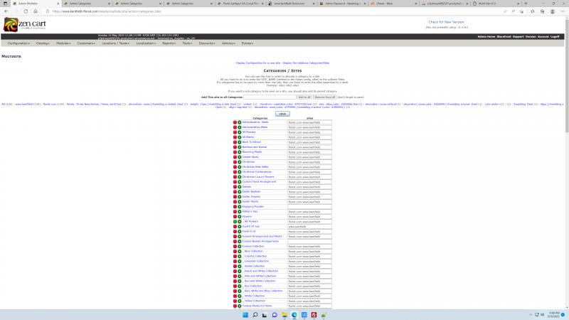

    I installed the mod on my site but i am facing a few issues.
    I am getting an error 500 when accessing the site but no logs generated.
    If I remove include_once('includes/config_sites/sites_switch.php') from includes/configure.php, the site comes back but it is displaying the wrong template.
    It shows ZC classic templates instead of my modified version of ZC responsive template.
    On the admin side, on categorie/sitepart of the multisite add-on, after inserting the site and clicking "add to all", it is getting populated in a strange manner ( seescreenshot)
    Thank you for your help.

    Your image is not hi-res enough for me to read - however this will NOT be the cause of the issues - you have a file missing or coding error somewhere.

    Sorry about the picture. screenshots did not quite work obviously.
    Here is another closer look:
    Since i am not getting error logs, the other issue is a lot harder to pinpoint.

    I think the picture you uploaded was where you show the categories to store.
    i uploaded a picture to show you what needs to be done to show your different stores
    I also uploaded another picture to show where you get the template name. each store your want created needs its own template.
    I hope I understood what you were asking
    naomi

    Here's the picture to show you how to add the store (template name) to the categories in multi-site.
    naomi
