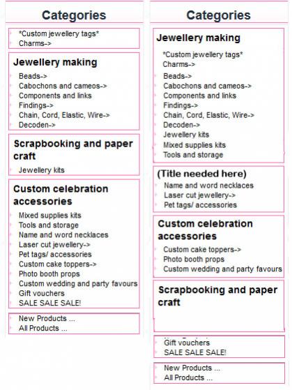

    I am having a little difficulty figuring out the code for this plugin. I have attached an image of what I currently have on the left, and how I would like it to look on the right. I cannot seem to get the placements right.
    Here is how the code looks...
    //example defines - copy & modify for each category desired
    define ('CAT_BOX_HEADING_#','group|divider/class|[imgname]|[imgalt][|headcontent|headclass][|headcontent|headclass]...');
    define ('CAT_BOX_HEADING_1','1|0|||Jewellery making|1');//new list - text headings - style 1
    define ('CAT_BOX_HEADING_2','1|0|||Laser cut jewellery|1');//new list - text headings - style 1
    define ('CAT_BOX_HEADING_3','1|0|||Scrapbooking and paper craft|1');//new list - text headings - style 1
    define ('CAT_BOX_HEADING_4','1|0|||Custom celebration accessories|1');//new list - text headings - style 1
    define ('CAT_BOX_HEADING_23','0|1|||Another Heading|2');//no list break - divider and text heading - style 2
    define ('CAT_BOX_HEADING_33_34','0|0|||Subcat Heading|3');//simple text heading - style 3
    define ('CAT_BOX_HEADING_48','1|0|cathead48.gif|Cat 48 Heading|Buy Now...|3');//image heading and alt text - can be followed by text heading(s)
    define ('CAT_BOX_HEADING_52','0|1||');//divider only - style 1
    define ('CAT_BOX_HEADING_53','0|2||');//divider only - style 2
    define ('CAT_BOX_HEADING_FEATURED','0|0|||Featured Heading|3');//no list break - text heading
    define ('CAT_BOX_SUBTEXT_23','Subtext for cat 23 escape apostrophe\'s|1');//subtext - style 1
    Can anyone help?

    You have defined CAT_BOX_HEADING_1, 2, 3 & 4, which will insert themselves above category ids 1, 2, 3 & 4, wherever they are located in the menu. You need to look up the actual ids of the categories you want at the top of each section and substitute those for 1-4.
    Also, comment out the example defines with // so they don't activate by accident, like this:
    //define ('CAT_BOX_HEADING_23','0|1|||Another Heading|2');//no list break - divider and text heading - style 2

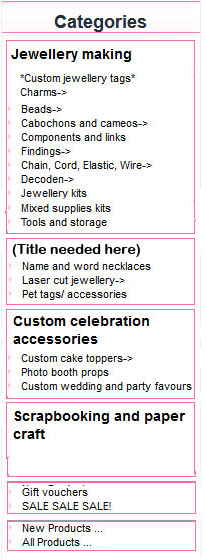

    My site is at craftjam.co.uk I have the design part correct such as colours, font sizing etc (I think). I want it to look like the image in the attachment below the code.

    Please ignore the image below where I put thank you. Not sure how I managed to add that? It is the first image that I need it to look like.

    The defines you show are only the default ones; but you actually have defines customized for categories 1, 3 and 4. Category 42 is already a catGroup header because it is the first category in the list, so I can't tell if you have a define for it. You obviously don't have custom header content defined for it.
    What does your actual current define list look like?
