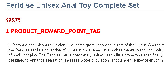

    so afr the only issue I tend to have now is the pic below...all apparently seems to be working correctly so try the uninstall and re-install of the sql first and see what happens....any idea on how to get this removed in the pic attachedName:  prp_tag.jpg

    If you would read a page back you might find what the problem is.
    Is your site Upgraded to the current version 1.5.4 Yet?
    zencart-upgrades-website-installation

    NEWSFLASH...yes I did see this...You are getting that error because you didn't upload the definition file or you didn't upload it to the right directory. It goes in includes/languages/english/extra_definitions/custom/reward_points.php. If the file didn't upload it will cause that
    and yes I did install it correctly...

    CountryCharm is right.. the only reason you see that text is due to a missing language file.. So let me ask this.. includes/languages/english/extra_definitions/custom/reward_points.php. Is the folder the rest of your template files sit in called "custom"? If not then this is the issue.. You need to re-name "custom" to match your template's folder name..

    all on my end is fine....I have been modding etc for years....I am un-installing it and trying fresh to see what happens I can see his point, yet doesnt mean he is correct as something else may cause it....If I find out what I will post no worries

    It means that there is an issue with the language file.. whether that mean it's missing or corrupted.. the cause is a language file..
