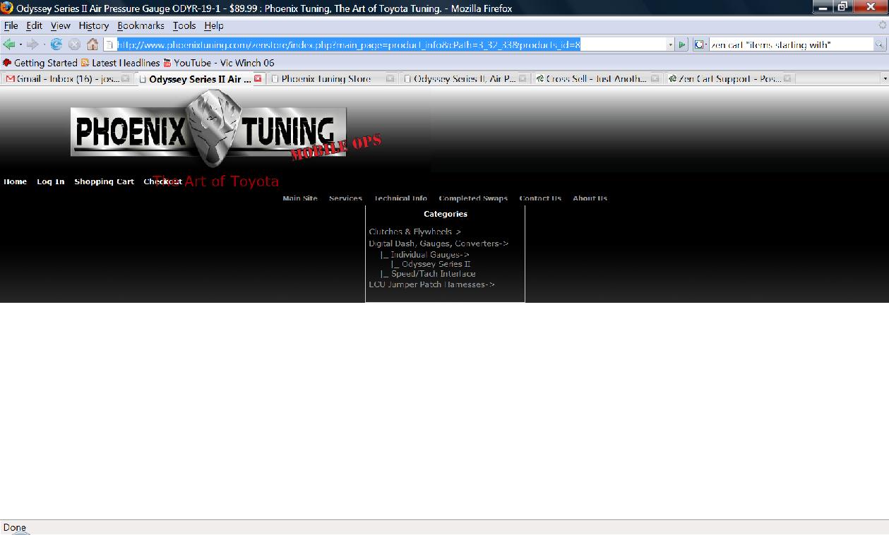

    I installed the Product Attribute Grid mod, and after working with it for a little while, decided that it didn't fit my needs. I went in and deleted only the files that I added (no files were overwritten, they were all new files that were added). Now, this is all I get when I go to look at a product:

    I'm not sure but I think I may have figured out what I did wrong. When deleting the files I deleted the whole extra_cart_actions directory. I didn't check to see what else was in there besides the absolute_products_with_attributes file that I was intending to delete.
    What else is in that directory and how do I restore it?

    Sounds like you may have accidentally copied the mod files into the default template folders? Looks like there are only 4 files with that mod, and 3 of them go into your (black) template folders - I assume you've removed them, but it wouldn't hurt to double-check. Then I'd copy the same files from a fresh Zencart zip file into the default_template folders. Seems like it would have to work properly after that.

    That did it. THANK YOU!
