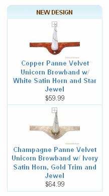

    I just installed the Recently Viewed Items sidebox, which I think is similarly coded as the What's New, Featured, Random and Specials sideboxes.
    If I set it to display more than 1 item, there is a line between each item. I'd like to remove that if at all possible and would appreciate any help.
    Here is what I mean:
    I'd like the items to be displayed without the separating line. I've tried hacking some tpl and module files but can't figure it out.

    Default Re: How to remove line between products in "What's New," "Featured," "Recent Products
    Try adding this to your stylesheet.css:
    #recentproductsContent {
       border-bottom: none;
       border-top: none;
    #recentproducts {
       border-bottom: 1px solid #DFF2F9;
    Teach them to shop and they will shop today;
    Teach them to Zen and they will OWN a shop tomorrow!
    Thank you so much, GEF! I can't believe how simple that was; I puzzled over this for over an hour.
    Thanks again!
