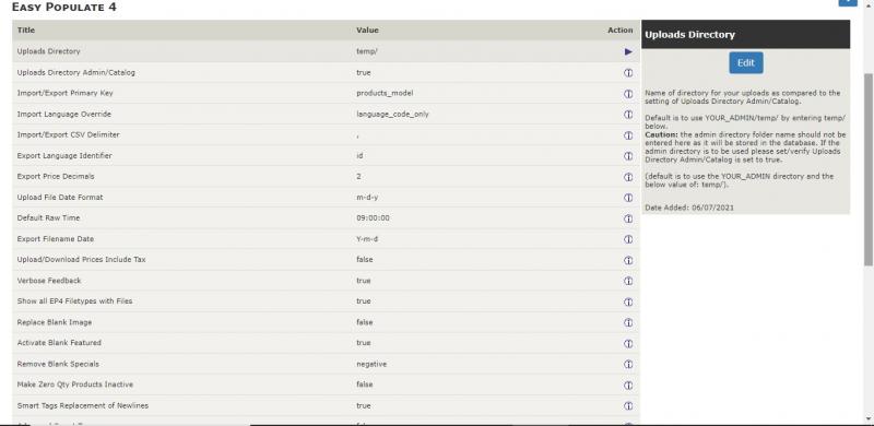

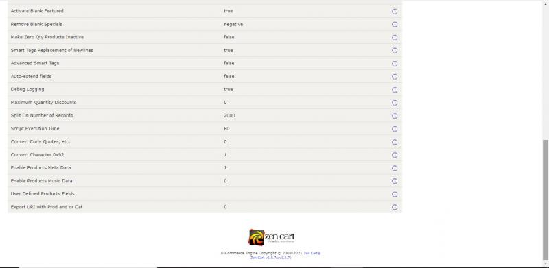

    Wow...Forgive me for not automatically knowing what you were talking about ....I thought I was giving you the info you asked for when I gave you access to the google sheets link... and I only saw it mentioned once.
    I have images of what the settings are in Admin/Config/Easy Populate. If this isn't what you are asking for please let me know. Obviously, I'm not PURPOSELY withholding information to get the help I need and am asking for.

    That is exactly what was needed to close the loop.
    As previously (perhaps confusingly?) described (or attempted) in the above linked post, but reworded here:
    In the list of configuration settings, starting from the top of the settings, please see the fourth option down that has the Title of: Import Language Override... For the file that was made available to peruse... Literally, change the setting to ANYTHING other than the current setting of language_code_only.
    The file shows language related fields to be using the XXXXX_1 style...
    If you click on that admin->configuration->Easy Populate 4 setting and look on the "right side" of the screen (bottom if using a mobile device): _1 references using the language_id whereas if it ended with the two letter abbreviation for the associated language (_en, _es, _de, etc...) then it would be fine.
    But, by this particular setting being set to language_code_only, then the only language related fields that are recognized are formatted like v_products_name_en, v_categories_name_en, etc... (for english)... Again, I have apologized now at least twice already for my mistake and will again as necessary, but to resolve the problem occurring where a "categories name" can not be found (right now it is searching for v_categories_name_en), either the file must have a column with v_categories_name_en (or whatever language is being imported) or change the setting of the above to literally anything else...
