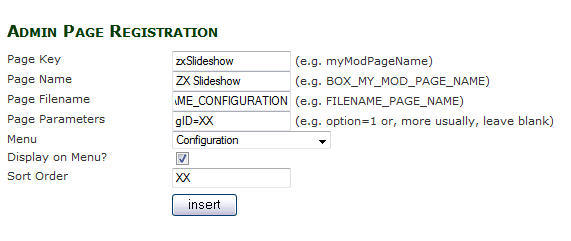

  10. #250
    Oct 2008
    Croatia
    1,616
    19
    Default Re: Admin Issue after moving site
    Quote Originally Posted by kcb410 View Post
    How on earth did you manage to get that?! Take a look at the screenshot attached to se how you're supposed to register the admin page. You will have to take a look in your database to find the actual DB entry ID in configuration_group table and replace the two instances of XX with your IDs.
    If the page key is already taken, just add 2 at the end (zxSlideshow2) or something like that.
