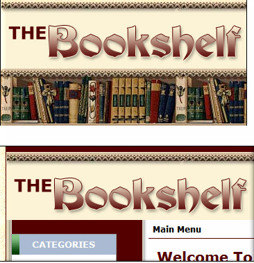

    The last issue with modifying the Classic to emulate look of Bookshelf can be seen in attached jpg.
    Top part of jpg shows heading of live store. Bottom part of jpg shows Classic attempt. I have been unable to find how to change where the sideboxes land , as they seem to bump up over the bookshelf image. Also, I can't seem to get rid of the Classic green/blue colors up on the left heading (it is EZ pages links, I hide categories and show EZ pages.

    It's doubtful that anyone will be able to help with your styling issues from a screenshot. We'll need to see the site.

    Your explanation of how stylesheets load and can override the sheet before it was very helpful. You nailed it on the issue. Turned out to be a clash of an add-on css stylesheet. I had installed stylesheet_css_buttons.css in the classic. When I modified to emulate Bookshelf, I had left that stylesheet in the css directory, forgetting to delete it. Going through each file in each directory, and deleting that in bookshelf/css directory immediately got rid of the issue.
