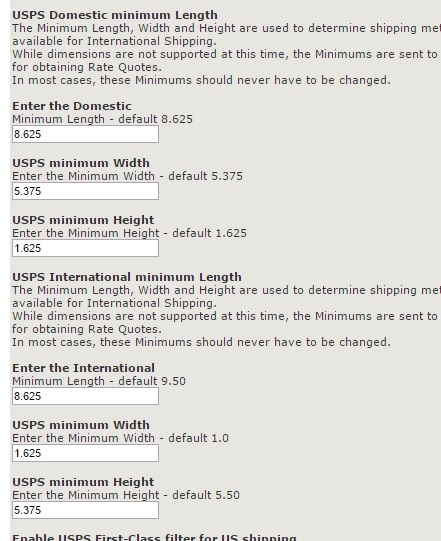

    Let me check with USPS as I am having issues with that too even when I make the changes to International Dimensions to allow for Small Flat Box:
    LENGTH 8.625
    WIDTH 5.375
    HEIGHT 1.625
    vs the default dimensions that you are using ...
    LENGTH 9.50
    WIDTH 5.50
    HEIGHT 1.0

    Silly me I tested with a $500 order and Small Flat Rate Box won't work > $400.00 ...
    Try changing your dimensions, do your quotes work correctly now?

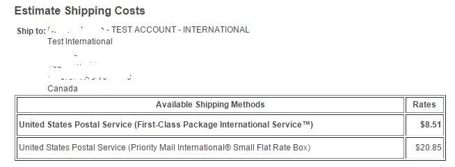

    I changed the international size to match the domestic and now it works!
    In the picture I have height and width backwards. I updated it to the correct height and width after that and it still works.
    LENGTH 8.625
    WIDTH 5.375
    HEIGHT 1.625

    Thanks for the update that this is working for you now ...
    NOTE: Those settings are actually commented in the code, if you like to try and read the code ...
