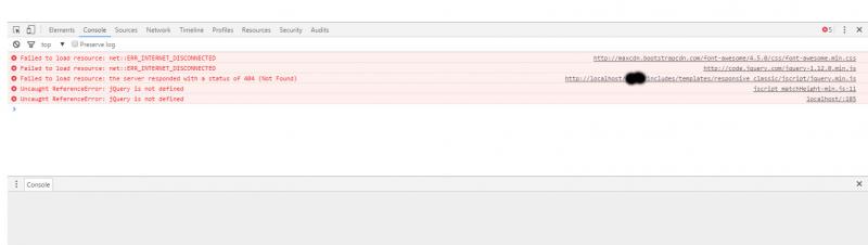

    OK done another new install & from the install link to storefront I get a blank screen, change the template to classic green & loads fine, switch back & blank screen.
    FYI
    ZC 1.5.5
    PHP ver 5.6.15
    MySQL 5.7.9
    Apache 2.4.17
    When using Chrome (my default browser) developers tab I do see issues, see attached image & guessing this is the reason for the problem?Name:  screenshot.jpg
    Any help or advise appreciated

    Quote Originally Posted by flashy275 View Post
    FYI
    ZC 1.5.5
    PHP ver 5.6.15
    MySQL 5.7.9
    Apache 2.4.17
    I can not see the errors in the image, they are too small. I have only installed on a live server. Maybe there is something wrong with your wamp set up?

    Default Re: Responsive Classic (built in to Zen Cart v1.5.5) [Support Thread]
    Those messages all suggest it's trying to load external resources and it can't find them because you're offline.
    I am only on localhost, I always disable my wifi when on localhost so defo no access to internet, I read many moons ago NEVER run wampsever whilst on the net, always disconnect....not sure were i read that it was so long ago. Am i unique doing this & is this the problem?
    BTW Anne, here is the errors in txt format
    Failed to load resource: net::ERR_INTERNET_DISCONNECTED http://maxcdn.bootstrapcdn.com/font-...wesome.min.css
    Failed to load resource: net::ERR_INTERNET_DISCONNECTED http://code.jquery.com/jquery-1.12.0.min.js
    Failed to load resource: the server responded with a status of 404 (Not Found) http://localhost/site/includes/templ.../jquery.min.js
    Uncaught ReferenceError: jQuery is not defined jscript_matchHeight-min.js:11
    Uncaught ReferenceError: jQuery is not defined localhost/:185
    This is only on responsive site(s) this problem occurs.
