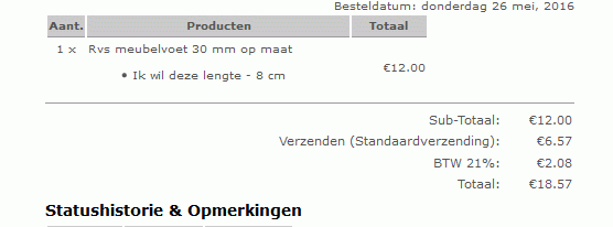

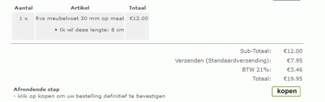

    I was going to place a bug report myself, but you beat me to it.
    I was called by a customer yesterday, which i recently upgraded from Zen Cart 1.5.4 to Zen Cart 1.5.5a that in his shop the shipping tax is not calculated on the order confirmation page. The shipping module used, is the table module. In Zen Cart 1.5.4 this problem did not exist.
    This is shown on the order_confirmation page
    and this on the checkout_success
    As you can see the shipping tax is missing.
