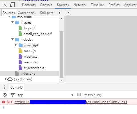

    Follow-up. When looking at the admin menu in the httpS/broken view, it's looking for an admin/includes/index.css that doesn't exist in the backup. I found and installed a copy, but that didn't help. I've also restored the admin/index.php to make sure it's the correct version.
    FWIW, I've attached screen dumps with the "Sources" tab from Chrome to show the error. I'm looking into the lack of a "CSS" folder showing up on the broken version.

    One interesting wrinkle, it's only doing it on Chrome on Win 10. Another station with Chrome on Win 7 doesn't have the issue. I've compared Chrome settings between the stations, and I don't see any significant differences.

    That makes it sound like it could be a cache issue? Have you tried clearing the cache?
  8. #8
    Aug 2009
    Greeneville, TN USA
    51
    Default Re: Admin CSS blowout while trying to install COWOA
    Well duh!
    Of course. Thanks!
    That's why it's always useful to have someone to talk through these things.
