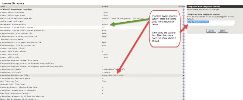

    I am trying to add spaces to my layout setting area (Categories SubCategories Indent and another field on this page). Obviously I should be able to add this to the field:   or this for a double space:    and save right? Pretty simple in the past.
    These areas did haves the space entered as default but I removed them during some testing. Now I want them back. When I add this coding    to this admin area and save it creates this:
    and no spaces happen where they should.
    It won't let me put the standard coding in the field it converts the & symbol to the html version. And it does not add the space if I put the cursor in the box and hit the space bar then save. It just stays blank. This seems like a bug to me. How can I enter the space coding and have it properly convert? Never had this before something is funny.
    See attached image below please.

    Thank you Gilby the solution you provided worked! I did perform a search before asking this question but for some reason just did not find the answer you provided. Anyway, I appreciate your help!

    What version of Zen Cart 1.5.5 are you running? I had no issue setting the Breadcrumb Separator to &nbsp;::&nbsp; in a ZC 1.5.5a admin. There were "sanitization" problems in the "un-suffixed" versions of 1.5.5, but that was corrected in 1.5.5a.

    I am running version 1.5.5a fresh install (I am fairly sure of this). I didn't have to modify the third file, that says if you have v1.5.5a no need to modify. And the fix worked properly. So I don't know why it didn't work for my 1.5.5a but did for you. But it is a slightly older 1.5.5a install. I installed it on 5/28/2016.

    Arggh, you're correct (of course). While 1.5.5a corrected many of the "over-sanitization" issues, the issue reported by @sports guy was corrected in v1.5.5c.
