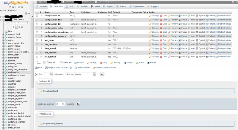

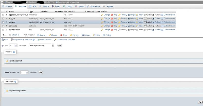

    Default Re: ZC upgrade fails from 1.3.9 to 1.50 using Zencart 1.5.5f install
    Thank you for the kind reply. Attached is the screenshots. I am just not seeing what may be obvious.
    Are those images from the existing down-for-maintenance live site's database or the new database that has received a "copy" of the live database?
    How was this copy/backup made/with what settings?
    For the applicable tables the EXTRA column is missing the setting of AUTO_INCREMENT for say log_id, etc...

    DrByte's database-backup FAQ still holds true for phpMyAdmin 4.7.7 (the interface has had a facelift, though!). Make sure that you've got a backup of the database's current contents, then use phpMyAdmin's SQL tab to run the following queries to re-instate the auto_increment on the four problematic tables:
    ALTER TABLE admin_activity_log MODIFY COLUMN log_id bigint(15) NOT NULL auto_increment;
    ALTER TABLE configuration MODIFY COLUMN configuration_id int(11) NOT NULL auto_increment;
    ALTER TABLE project_version MODIFY COLUMN project_version_id tinyint(3) NOT NULL auto_increment;
    ALTER TABLE upgrade_exceptions MODIFY COLUMN upgrade_exception_id smallint(5) NOT NULL auto_increment;
    That should get you past your current hurdle, but there's no telling what other bug-a-boos are lurking in that database's structure.
