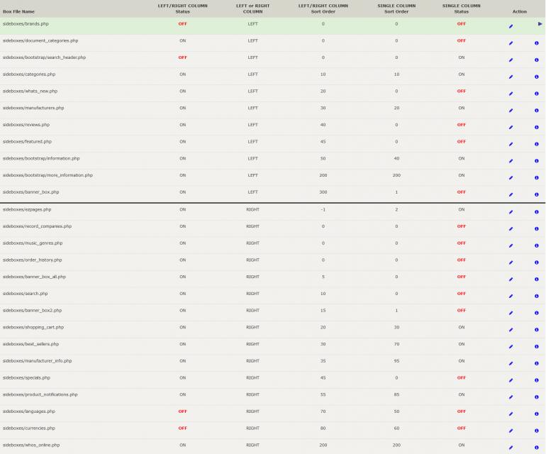

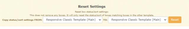

The whole point of the issue was that the standard zen cart sideboxes were not working out of the box, at least for me. When I went to the sideboxes screen after a fresh install, everything was disabled, so I had to copy them using the reset command, which states:
Also, the sidebar setups for the default and responsive themes are not different:
Of course, this just means it's what I had to do to get the 3-column behavior advertised in the preview screenshot and template description, obviously there are no "objectively correct" settings for the sidebox setup. I guess the important takeaway here is that for some reason, on a fresh install, ZCA defaults to having no sideboxes enabled at all, even when the standard themes have sideboxes enabled. I am not sure why this is or if it is expected behavior, it's just what i experienced, you know?
With bootstrap not being the default template, the fact that you changed templates was the reason the layout boxes controller needed to be reset.

> Is this functionality not as included in ZC158:
Not exactly. I believe the built in capability only populates the dropdown with templates that already exist under includes/templates. So the built-in utility is not as powerful in an upgrade situation, where the old template might not have been copied to the new install.
It's really up to the template author whether to install sideboxes by default; Bootstrap starts clean so you don't have to delete anything.
To clarify that the next step after template switching is sidebox selection, I added a sentence to that effect to the template selection FAQ:
https://docs.zen-cart.com/user/admin...ate_selection/
