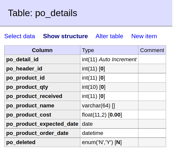

    you really need a PO type of system. which would involve a number of tables such as:
    an example of the po_details table:
    and then you would need some code to input this table. and it all should tie to your products table.

    This is the sort of approach I was thinking might at one time help... This I will have to give some thought. I suppose on easypopulate import, the added quantity could be added to what's there?
