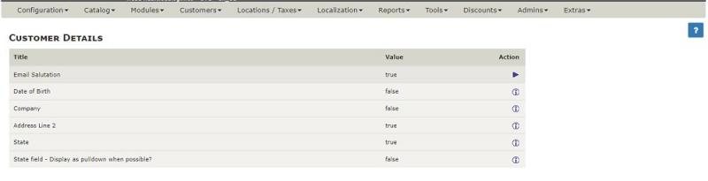

    I am in the process of upgrading to version 1.5.8.
    Configuration, Customer Details page does not have an edit button. Confguration, MY Store does have an edit button.
    Can anybody tell me why the edit button is missing and how I can get it back please.
    I have attached a screen shot of the Customer Details page with no edit button.

    The My Store is still the new version 1.5.8. In Admin if I go Configuration, My Store, I have an edit button. If I then go to Customer Details there is no edit button. So 1.5.8 has an edit button on some pages but not other pages.
    My actual store is still running version 1.5.7d The new version 1.5.8 is in a subfolder and it will remain there until I am sure it is all ready to go live as my new store.
    I have no issues with version 1.5.7d. As far as I know the only issue I have with 1.5.8 is the edit button missing on one page in Admin. I don't understand why the edit button is showing on other admin pages but not on the Customer Detail pages..

    in Admin version 1.5.8 all of the listings in Configuration have an edit box except for Customers Details page
    I have downloaded the log files and the errors I am looking at are not files I have touched. I haven't customized these files ever.
