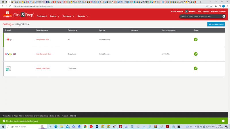

    I know a few would most likely be interested in the royal mail module i had it whip up yesterday.... that and i'm really curious if this method works
    Anyone curious in the experiment enough that they fancy testing the module out in a test environment to see if it does indeed work as intended?? i mean here's the screenshot of the fileset, looks like a module to me :S

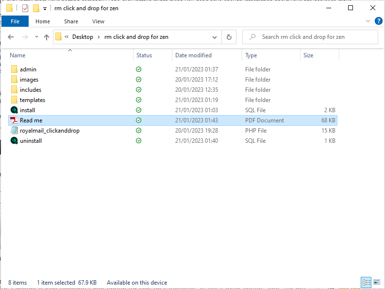

    it even made the read me on command!!

    Also if you need klarna or would like to test a klarna module whipped up by the same tool?

    It has been recognised by royal mail as an app and is indeed connected! I haven't been able to find anything like this and if i can iron the install into a smoother process and resolve the bug that stopped me proceeding to checkout pages in the module then i've cracked it. i mean it will probably need some optimisation to work as intended as i cant see settings i asked it to give me control of in the admin panel just yet, hoping the code errors have just stopped the script showing the options in the admin panel, currently it just seems to have the option to enter the api key which it does at least handle correctly to result in a successful connection to royal mail OBA
