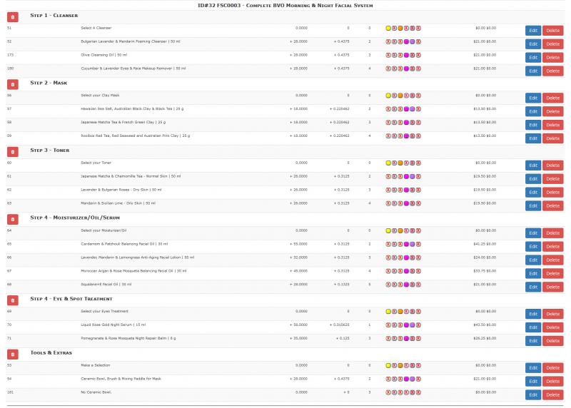

    Again, welcome to post the configurations, interested in items that are flagged as base price, default (or not), display only (or not) and sort order at least as relates to attributes marked with the two previous settings. DPU will display a starting at price with the lowest calculated price possible when no attributes are selected based on those settings. Also note on one or more of the referenced product that there are some "steps" that are duplicated. Didn't make sense to me, not sure about other customers.
    Sorry! I was trying to figure out if any of the changes I had made to the classes>dynamic_price_updater.php file were the culprit, but no.
    Here are the attribute settings for that product. This is a build your own system type of product, the reason why there were duplicate items.

    Both images have their "problems", but I believe I can see all that is there. So, I don't know that I have ever seen priced-by-attribute product setup this way in an operational store and perhaps there is something about the code that doesn't know how to handle it (even though it is code borrowed from the ZC equivalent. What I would expect is that all attributes at least other than the "please select..." ones to have the base price marked. Regardless of if the "lowest" priced one(s) were marked. If nothing else, future management of them is made easier in that do not need to "search" for the cheapest and make sure it is marked if say the individual prices get changed. I'll try to setup a product this way, but may I recommend taking a look at a store installation that has the demo product installed and look at the setup of products 132 and 160 (both are golf clubs set to be priced by attribute). All of the clubs are marked as base price. Unfortunately, you don't see the highly recommended "please select" option in these (nor many/all?) option names.
    Leave it up to me to figure out a way to use priced-by-attributes in a whole different way that is not supposed to
    I don't have a store to play with that would have the products you suggested. However I did tes with different settings and this is what I found.
    1) Marking all of the options as base price except for the "select..." with DPU on and the behavior didn't change. I turned off DPU and it works just fine. The price comes down to $135.00 Sale: $101.25 which is the calculation of all the lowest price options.
    2) I removed all the "select ..." from the options and marked all options as base price with DPU on and the same behavior is present. I turned off DPU and it works fine. The price comes down to $135.00 Sale: $101.25 as in the previous test.
    3) Having all the "select... " removed I marked only one option on each pull down as base price with DPU on and the same thing happened. I turned off DPU and it works fine. The price comes down to $185.00 Sale: $138.75 which is the calculation for the base price options I marked.
    Another thing that I noticed the original price doesn't display in this setting, only the sale price, opposite to what was happening before.
    It's quite interesting this behavior happens only with this product. The rest of the products in the entire store work fine. Granted I don't have other products with these many priced-by-attributes options to compare. I can't think of any other ways to set up this product so that DPU is ok with it.
    Sorry for the headache I gave you today.
    I'm hoping at least for now customers will figure out by changing the selections the price updates to reflect the sale.
