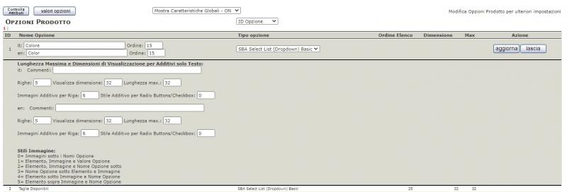

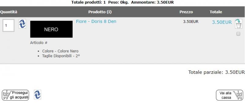

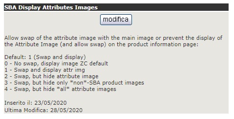

    hello, in the photo you can see the attributes (colors) of an article in this case SBA is in Off selector 0, if it is selected in position 2 it is not possible to see the images of the attributes as in the photo
    Attachment 19014
    also that it is in position 0 or in position 2 when I insert an article with image attributes in the shopping cart I display not the main photo but the attribute (color) as seen in the photo
    Attachment 19015
    this selector, next photo, I believe it allows the exchange, but it does not work in any position
    Attachment 19016
    I would like if you can see as in the first photo with image attributes (colors) SBA activated position 2 and view quantities available in the warehouse, and when you insert it in the cart see the main image of the item not that of the attribute (color)
    can you please check if everything is correct thanks so much for your availability
    The image swapping is intended to work for the SBA simple Select (dropdown) option name type. As I believe I commented earlier, the option name type for this/these attributes (catalog->option name manager) should be changed away from the first option in the list which is dropdown to the one that has been added for SBA. As for the swap occurring on the shopping cart page, there currently is no admin switch to disable the swap. The capability is provided and it can be disabled by code. That said, I have locally written some extra code to disable the swap if the option is set to 0.
    Again, that selector is the correct one, but the swap on the product information page will only occur when the dropdown type is the SBA dropdown. There is also a separate plugin for attribute image swapping that works with SBA (I actually had to disable it to track down the issue(s) above).

    I'm sorry, I tried to try alone to solve this last problem of mine, maybe the translation of google traslator is wrong or it is I who am I can not understand.
    I ask you for help, I read and reread what you wrote and I tried before writing again, but for me it is too difficult.
    I try to explain myself:
    I go to catalog -> option name manager type of option SBA Select List (Dropdown) Basic settings as in the photo
    The visualization of the image attributes (colors) in the article page, I only get it with single attributes, or with Dynamic DropDowns off (0) if I have multiple attributes (sizes + Colors) I cannot get the display of the attributes (color images ), my shop must have size and color, the colors I wanted to see on the product page. Is this possible with SBA?
    to disable the exchange of the original image with the attribute (color) on the cart page, I understood that I have to manually change the code to 0 but I did not understand in which file I must search.
    Forgive me but I can't solve it, thanks again for your help.

    Quote Originally Posted by snakes7575 View Post
    Actually, that was very well stated and I fully understood it.
    The problem is that currently Dynamic Dropdowns does not fully support image swapping without making some code modifications. I've worked out something of a solution, but there also are a number of ways for images to be captured/stored for display, whether it is stacking images atop each other, merging the images as appropriate and storing those merged images, etc...
    Right now I have it so that as an option is changed the image changes either to the image that is assigned in the attributes controller for that one option value. I am trying to identify a way to do a lookup based on the selected attributes; however, I'm getting to a turning point where I may have to do a bit of work to make that happen, not to mention that I will need to modify one of the tables and add features in the admin to be able to address/update the images.
    I was able to make a minor modification to the code to support attributes image swap for dynamic dropdowns; however, as identified image swapping seems to work for multi-attribute product, provided dynamic dropdowns are not active which also has an impact on customer interaction..
