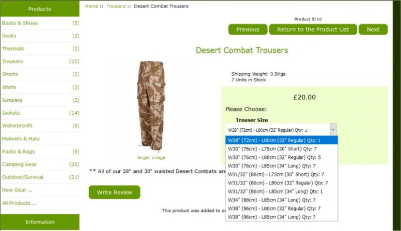

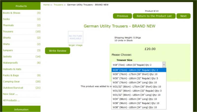

    Jun 2020
    Scotland
    11
    Default Re: Stock by Attribute v4.0 for Zen Cart 1.3.5
    SBA Version 1.5.4 for Zen Cart Version 1.5.6c
    Have some issues with this and cant work out what's going on.
    Please see pics below
    Pic no1 shows the SBA page for an item on my site. The quantities on this page are correct.
    pic no2 shows the option dropdown for the product on the website. As you can see these options are NOT correct according to the SBA page...
    pic nos 3 and 4 display same pics for a different product. Again the stock on the SBA page are correct but the options drop down on the product page are wrong as well...
    Have same issue with some of the other products in this category too, though not all of them...
    ANY IDEAS ???

  9. #3279
    Jul 2012
    16,734
    17
    Took a moment to identify the presence/absence of all of the images. For those that are unable to see the pictures for whatever reason, please at least allow me to describe two of them as the other two tell the same story.
    In the first image, we are shown the admin screen portion of SBA for the given product where there are three rows of data showing quantity for each of three different option value selections within a single option name. The quantity of stock is different for each of the three option values which is also different than the total quantity of stock marked as available for the product stock quantity. In a second image, we are shown the catalog side of the store showing the product information page with all of the attributes assigned to the product and the stock quantity identified to each attribute (option value off of the one option name).
    In this second image though there are more than three selections displayed. Here there are 10 or more selections displayed. The quantity of stock entered for the firs three shown in the admin match, but the other 7+ displayed options all appear to have the quantity that the overall product has...
    This *is* a feature of SBA... it may not be usable in some stores, it may cause complete confusion in others, but it is part of the design. The concept is this: to limit the sale of quantity of product, one must identify the quantity of product that is available. By not defining the individual quantity, the quantity available is that defined by the product.
    Thus, to remove the availability of the other option values, either the option values should be removed from the product or the quantity available for each of the option values should be identified even if it is a quantity of zero.
    Of course, even with a quantity of zero, there comes the question of whether the "product" should be displayed. If the answer is no, I ask the question of why the option value remains assigned? If the answer is yes, I suggest reviewing the out-of-stock options to be sure that they "one day" will be returned to stock.
    Sorry for the delay in responding, it's been a long day, but from the design perspective what you are seeing is "correct"... it may not fit your store or desired expectation but is functioning as designed/expected.
