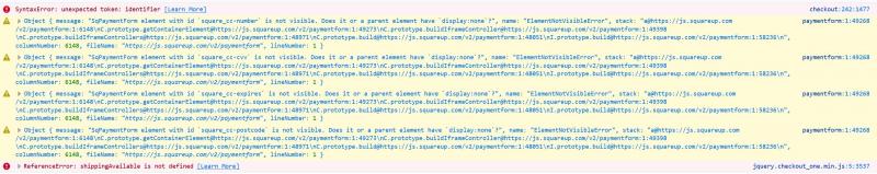

Thanks, @haredo, that nailed it. The issue is that the Square payment module is creating a jQuery/javascript error and preventing OPC from continuing.
See this image for the console-log. What version of Square are you using?

There was a similar issue with that module previously, but you should report it to the Square Payments' payment-method's support thread.
It affects OPC due to OPC's heavy use of jQuery; I'm guessing that the console log will still be there on the 3-page checkout's confirmation page but doesn't wreck as much havoc.

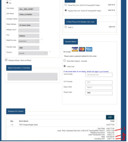

- 3 issues in order total box (numbered 1, 2 & 3 in screen dump):
- ISSUE 3: Express Post cost in order-total is incorrect: it quotes the ex-GST price ($17.95) instead of incl-GST price ($19.75)
- ISSUE 4: GST calculation is incorrect: it doesn't include the postage GST; shows $7.18 instead of $8.98 i.e. it's lost the GST for the P&H charge added within the AUPost module
- ISSUE 5: the total shows a rounding error: total of figure above should be $99.08, not $99.09 (I have tries various suggestions from ZC forums to correct this - but no luck yet.)
Attachment 18176

First, thanks to @GerriM for granting me access to her test site so that I could investigate the issues she identified.:smile:
There are actually two underlying issues that I've identified and currently opened as issues on the OPC's GitHub repository:
Square payment inputs disappear after shipping-method change
The Square (and possibly other?) payment-method has an external jQuery script that's loaded on a full-page load, so when OPC re-loaded only the payment-selection block, that processing didn't kick in ... resulting in no input fields for the Square credit card information.
My current approach, validated by @GerriM, has its limitations. For the Square module to operate properly when the shipping method changes, it's necessary to not re-load the payment-choices block. Unfortunately, there are payment methods that are dependent on the shipping method selected (like enabling a Cash payment only when the shipping-method is store-pickup), so these payment methods absolutely require that the payment-choices' block be updated on a shipping method change.
The approach I plan to take (unless a better solution is proposed) is to add another configuration value to the One-Page Checkout Configuration, allowing a store-owner to identify payment methods that require no reload of the payment-choices' block; that setting will be initialized to identify the square method by default. What this means to store-owners utilizing OPC is that you can't have a combination of payment methods that require the block to be updated and those that require the block not to be updated.
If anyone has a better solution to the issue, I'm open to suggestions!
Taxed order-totals 'lose' their tax on payment method update.
This one was caused by the payment-method update's AJAX not initializing the order's shipping- and payment-classes prior to requesting the order-total modules to perform their calculations.
I'll be updating the OPC's GitHub in the morning with my current changes.

Since I couldn't find this referenced on the ZC forum, here's some info in case it can help another not-so-experienced Zenner out there like me. Cindy, please see text in blue below re whether this affects OPC code.
An OPC javascript-like error started to appear i.e. on checkout entry, instead of the usual OPC screen, only this is displayed:
HTML Code:
Sorry, but our expedited checkout process cannot be used. Click here to use our alternate checkout process
FYI, javascript errors (Firefox: F12; Console menu) displayed while SQUARE was enabled (the middle ones disappeared when SQUARE was disabled): Attachment 18321
However, I couldn’t track the problem down & resolve this issue for ages because, just through bad luck, a server PHP version issue happened at the same time and 'muddied the waters'. But more about the PHP issue later…
My system: ZC1.5.5e; OPC v2.0.5; Template: RSB v2 modified; various payment & shipping modules including SQUARE v, Direct Bank Deposit & Australia Post Shipping Modules; lots more plugins & mods. My website: (currently under development so closed for maintenance): https://recoveredheritage.com.au/ .
First, the OPC issue + solution:
That OPC error message was caused by 2 x database entries in my zones table including an apostrophe: Côte-d'Or & Côtes-d'Armor. Internet research mentioned that one could use "a SqlParameter object to pass in values...so you don't have to worry about the apostrophes users enter in". However I did a manual work-around (replaced those apostrophes with spaces) since I'm not sure whether OPC has that functionality or if one of my other mods is interfering.
Where did the apostrophe errors come from? Back in January, after getting OPC to play well with SQUARE (with Cindy's help - thanks), I added extra countries into my zones table in the database using ZC plugins including this one. After working through ZC1.5.5 compatibility issues with the old ZC version SQL files, I did lots of testing...and thought I had nailed it :no:. When I tested OPC the next day or so, I started getting error logs at the same time. With hind-sight being 20-20, I now know those error logs had abolutely nothing to do with the OPC issue but were, instead, to do with the PHP issue (below). But I didn't know that then so... since a site can only have one active PHP version, I headed in the wrong direction and started in on upgrading to PHP 7.2. :oops:
Now that this OPC issue is solved:clap:I've reverted to backups and am free instead to progress towards launching the website (using PHP 7.1) while upgrading to ZC1.5.6(maybe b) locally with WAMP where I can run PHP 7.3 while testing.
And now the PHP issue:
Don't take it for granted that your hosting company will tell you when they upgrade the server PHP default version to 7.2. Mine didn't (inMotion hosting). So...if you start getting error logs out of the blue like these ones, investigate whether you can just change your site PHP version manually back to PHP 7.1 FIRST - before you assume you have to do a full PHP 7.2 upgrade like I did.
While I still had to address a few error logs even after I had reverted to Site PHP 7.1, there aren't too many so far. I think these occur when the cPanel currency cron job runs &, of course accessed the default server running PHP 7.2. (I haven't yet been able to get the SQUARE cron job to work...so fingers crossed.)
Hope this helps.
