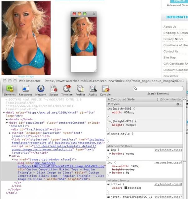

Image hover and resize issue:
ZC v1.5.4
IH v4.3.2
All install went through with no problems, image loaded with all the resize with no problems. But when trying to view it on the product page, the hover zoom doest not happen and clicking on the image does not bring up the large(original) image. Any suggestions is greatly appreciated.
link here : https://www.waterbabiesbikini.com/ze...&products_id=1

The image hover is functioning correctly. The issue is the zoom function. The product image is displayed with the option of click to zoom to bring up the large picture, the pop up window size is calculated from a call to the image height and width, but instead of calling the dimensions of the larger image, the smallest is picked up. So the end result is a tiny window displaying the small image when the user click on the product image to enlarge. Granted you can resize the pop up window and make the image bigger but i think everyone would agree that is counter intuitive.
i fudged the code here to get the popup window/image sized correctly:
/includes/modules/pages/popup_image/jscript_main.php
/includes/modules/pages/popup_image_additional/jscript_main.php
original code
imgHeight = document.images[0].height+20-i;
imgWidth = document.images[0].width+20;
new code
imgHeight = document.images[0].height+810-i;
imgWidth = document.images[0].width+590;

Right and while this solves YOUR resizing issue, this is not a reproducible condition in a clean Zen Cart install with IH4 installed. This is not a fix that will be incorporated into IH4, because it cannot be consistently reproduced, and I'm not suggesting that anyone else implement this change either...
IH4 is NOT working on your site.. None of your product and category images are being served from the bmz_image cache folder.. This is a telling sign that IH4 is not configured/installed/running correctly..

I am not certain as to how you determined that the images are not served from bmz_image. I only uploaded 2 product pictures via IH, both were resized by IH and placed in the correct places. If you are correct and IH is not working and the images are not from bmz_image, then what else would automatically resize the 2 images I uploaded using IH and place them in the correct locations?:unsure:
Here is a screen shot of IH and the resized pics, let me know if you need any other info to trouble shoot:
Your small and medium images appear to be coming from the bmz_cache folder.. If you right click on the product image on the product page you posted, this is the image URL: https://www.waterbabiesbikini.com/ze...ge.199x300.jpg. The small image URL is: https://www.waterbabiesbikini.com/ze...mage.60x90.jpg
The large product image is not coming from the bmz_cache folder at all.. Click on the "larger image" link, and right click on the image in the popup window.. This is the URL of the image: https://www.waterbabiesbikini.com/ze...m%20bikini.jpg. Note that this image is NOT being served from the bmz_cache folder.. and this is because you have NOTHING in the large image settings.. (I JUST tested this use case and confirmed that this is what will happen if you have no values in EITHER the large height or width)
Now this doesn't resolve the original issue you had with the large image popup, and it's not an issue I can replicate.. It's also not something that's been noted as a known issue at all.. I am unable to say what the cause MIGHT be as it seems to be part of your specific setup...
Re: Image Handler 4 (for v1.5.x) Support Thread
DivaVocals
Forgot one last thing.. Thinking that not having large image dimensions defined in the IH image settings is the likely cause of your original issue..

Thanks for looking into this. After carefully reviewing your suggestion and testing, here is what I found (so far):
According to the configuration description for IH large image under admin-configuration-images:
"IH large images maximum height
Specify a maximum height for your large images. If width and height are empty or set to 0, no resizing of large images is done."
This simply tells me that IH will not resize the image.
I have tried to enter the dimensions and here is what I found out. If I entered dimensions that exactly the same or larger than the original image, IH will not resize the image and it will be served from the directory where IH uploaded the image to. However, if the dimensions are set to something less than the full size of the original image, IH will resize the image to fit and this will be served from bmz_cache. This however will not resolve the issue of the image being served in thumbnail size. Here is a screenshot of how the image appears and the code, note that it is now from bmz_cache and the dimension is defined as 650x978.

If there is NO re-sizing, then there is NO processing of the images by IH4 at all, and so YES, they will be served up from their original location. You are also correct that in order for the image to be re-sized and cached that at least ONE of the set dimensions in the settings must be LESS than the original image dimensions. This applies NOT just for the large images, but the small and medium images as well if you choose to upload a separate image for small and medium images versus letting IH4 create these images for you.. There are a FEW small image settings, and Zen Cart allows you to set them all differently if you so desire (ie: specials thumbnails can be different dimensions than the new products thumbnails for example), but in doing so, you will not be able to use the IH4 image hover feature. IH4's image hover feature is disabled if the small thumbnails on the product listings are not ALL the same dimensions..
The reasoning behind the re-sizing logic is that IH4's PRIMARY purpose is to handle all of the re-sizing and image optimization work for you. If you upload images sized and compressed, you would NOT want the image processed again.. So it requires the image dimensions settings to determine if it should process an image or not.
The history behind this assumption is this:
Many shopowners have images that are sized at very large dimensions from digital cameras or supplier supplied pics. Many of these images are 2000+ pixels (height or width) and are at a very high resolutions which increase the overall image size. Historically shopowners would use these images and rely on "artificially" re-sizing the image dimensions using CSS or inline styling with default Zen Cart settings.. While the images would LOOK the right size, these techniques merely changes the screen output, but behind the scenes these images are still the same size and dimensions and when they load, they will impact the page load. Many shopowners do not have the photo editing tools (or skillset to use them) to edit their image sizes, and optimize them for the web. Also for many busy shopowners, this editing and optimization work is time consuming.
IH4 takes the work out of photo optimization by not only sizing the images to the dimensions the shopowner desires on the fly, it compresses the images so the file size is reduced and this helps with page load/performance.
If the large images being uploaded are ALREADY sized to the shopowners preferences then IH4 will do no work on the large images. It will then process the small and medium images UNLESS the shopowner uploads a specific small and medium image. Again, if the small and medium images uploaded are already re-sized to the specs set in the image settings, then IH4 will not process them.
Thinking that before I submit the IH4 update I have in the works that I should update the configuration on screen instructions and perhaps add a little sumthin' to the readme to cover this a little better..
That said your original reported issue with the thumbnail being served up when you click the larger image is still not an issue that I can replicate. Without more widespread reporting of this issue (it's not a "common" issue as you originally asserted), and the ability to replicate this issue, I do not believe it is an IH4 issue. Suggest you try downloading the version on my Github repo which has been updated for v1.5.4 of Zen Cart and see if it works WITHOUT your modification..
