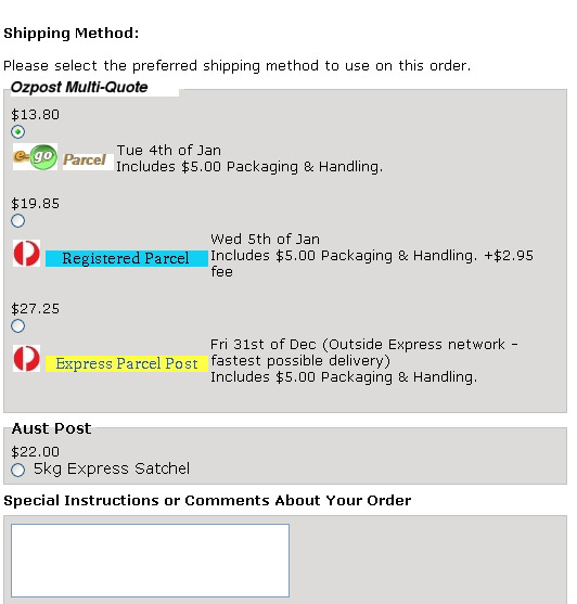

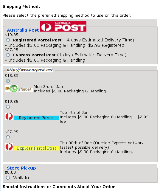

OK I have finally had a win!! If you disable a a few Aus Post options ie regular sachels and click yes to hide parcel rates if sachel sized I now get my TNT rates for ALL products.
Re: ozpost shipping module
Ok now I have another problem if you go to my site http://superiormarinegroup.com.au/ca...products_id=49
Add this item to the cart and you will see the shipping methods change with 1 Qty then 2-3 Qty and then 4-7 Qty and again at 8. How is it that TNT is there at 2-3 Qty then disappears and comes back at 8?

Olsta

Olsta
Alas, in spite of all of your testing, and everything that debug provides, I still think you are *guessing* rather than *understanding*.
Remember: The SERVER provides what is POSSIBLE
Your config settings determine which of the POSSIBLE methods are ALLOWED.
The "Hide" switches affect what the server will consider POSSIBLE by triggering an 'early abort' - IOW, if letters are good enough (hide parcels) then the server won't even attempt parcel rates (including couriers). Likewise, if the serverr can get a valid AustPost Quote and the 'hide couriers' is set, then the server won;t attempt the courier rates. If NOTHING is 'hidden' then ALL quotes are returned, letters (if possible), parcels, even if they are letter sized, parcels, even if the items will fit into a satchel, and so forth.
It is no more compicated/simple than this. I haven't identified any problem with your store, and you haven't provided me with an explicit example that I can quickly verify your issue (and as implied in other messages, it is a wast of time for me to try to 'guess' what item(s) are causing a problem.
And finally, PLEASE USE THE DEBUG!!! Watch the parcel weights and dimensions, check the delivery destinations ... as these can all have an effect on the output.
Anyway.... on to your next message......

One more problem I have... hopefully last lolz.
When I view order details in admin. Sometime shipping want to display as images but it can't find the images, when I view the source file...the image is pointing the template folders... but it was looking in admin folder instead of normal folder... and as you know that it will not find the image because its not in there.
http://img440.imageshack.us/img440/4...ceshipping.jpg
Funny thing is that it does not happen all the time (most of the time though)... and when this happen we can't really tell at all what option customer has select (my clients can tell because they know that this price is for which option)
I have no clue why this is happen.

In addition I also seem to be getting 2 sets of quotes one from V 2.2 with images and an earlier version (maybe???) without. Ego comes up after the first 2 which is what makes me think I am getting 2 sets of quotes.
Available Shipping Methods. For your protection, all regular parcel rates include registration Rates
Australia PostRegistered Parcel Post - 4 days Estimated Delivery Time)
- Includes $5.00 Packaging & Handling. $2.95 Registered. $19.85
Australia PostExpress Parcel Post (1 days Estimated Delivery Time)
- Includes $5.00 Packaging & Handling. $27.25
E-go Parcel Mon 3rd of Jan
$13.80
Australia Post Registered Parcel over 500gm Tue 4th of Jan
Includes $5.00 Packaging & Handling. +$2.95 fee
$19.85
Australia Post Express Parcel over 500gm Thu 30th of Dec (Outside Express network - fastest possible delivery)
$27.25
Store PickupWalk In $0.00
I have uninstalled and re-installed but still come up with the same result.
You may have seen this level of incompetence before ???
PS: Subscription the subscription is cheap. Accurate shipping costs are very complex. Hope it's working out.
With DEBUG enabled you will/should see two sets iof quotes.. The first messy looking set is what is returend by the server, the second set is what is displayed to the customer. Usually these will match, but if you have disabled some methods these will be missing from the customer view.

Regarding the 2 quotes, after turning off debug this is what I got (with 3kg XL satchel) enabled:
6 quotes and still outside the Express Network (probably update overnight I guess).
http://www.charcool.com/shop//images/shipping.jpg
Thanks again. At least I now understand what I didn't know.
Rod
Yep had the old Aust Post module running in tandem.
Looking better now - although 4012 still seems to be outside the Next Day network.
A possibility for overcoming the satchels issues (which ones do you have/offer) is to clone the Store Pick Up "Walk In" module so that the text you input in
includes/languages/english/modules/shipping/storepickup.php
shows your satchel. The price can be controlled from Admin - Modules - Shipping.
Downside is that it will still be offered for everything - very small products (overkill) and very large (won't fit).
I am aware from http://shop.vcsweb.com/ that there are only a small number of sites using the paid Ozpost solution, so my problem is probably pretty rare.
If I was oo.com.au I'd pay a programmer to make a more elegant fix but for now this will probably do:
http://www.charcool.com/shop/satchel.jpg
