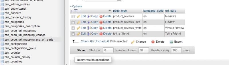

For index.php?main_page=contact_us you must enter a record in the database manually according to the section of the docs "Adding a URI Mapping for Other Zen Cart pages".

Go to your database and follow the picture example for each url you are wanting to create.
Attachment 13264

Unfortunately this support thread cannot teach you how to use the PHPmyAdmin tools.. the readme instructions are clear, but if you do not know how to use the tool required to do this, this is not place to teach you.. now you can either pay for help with this or spend some time learning how to use the PHPmyAdmin tools..

Re: Ceon URI Mapping v4.x
countrycharm
Attachment 13264
Attachment 13286
After Do that. about_us

DarkAngel
In Zen Cart <= 1.5.2, requests for an EZ-Page which does not exist simply display a blank page. Can you verify the page you are trying to change the URL for is actually an EZ-Page (part in red indicates EZ-Page)?
"/index.php?main_page=page&id=11"
If you wanted to redirect the Zen Cart "specials" page (part in red indicates specials page), section 10 (method 1) of the CEON URI readme covers this subject.
"/index.php?main_page=specials"
