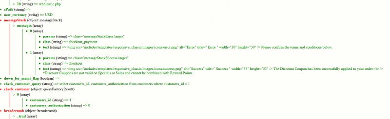

In regards to the Coupon, Reward Points, and Gift Certificate. Every time the APPLY button is hit to update the data on the shopping bag, the only message generated is "Please confirm the terms and conditions below." without acknowledging either coupon code, reward points or GV code were accepted at all or generated some errors.
Would it be possible to generate the appropriate messagestacks for each of these? and if so how?
Thank you Lat9. I removed all the template overrides I made, which with the exception of tpl_modules_opc_submit_block.php only had cosmetic changes, and I ran some tests with both OPC on and off and this is what I found.
1) With OPC OFF: If I add a valid coupon, if I add an invalid coupon and if I remove a coupon all messages are produced. If I use reward points no message is produced.
2) With OPC ON. If I add a valid coupon, no message is produced. If I add an invalid coupon message is produced. If I remove coupon message is produced. If I use reward points no message is produced.
If I'm not mistaken reward points doesn't generate any messages at all (??). If the issue was my template overrides removing them would fix the issue, but it doesn't. What m I missing? How could I figure this out?
@mvstudio, using zc156c and OPC 2.1.3, adding a valid coupon results in a "Congratulations you have redeemed a discount coupon" message at the top of the one-page-checkout page's display.
A couple of ideas:
1. Install Report All Errors, setting to report all non-duplicate-constant errors on the storefront. See if any PHP notices are logged.
2. Install Superglobals, enabling that to display on the storefront for your IP address. Check the contents of the messageStack.
I didn't try that actually. I assumed the APPLY button wouldn't need the T&C box to be checked. A customer might not know that and do the same I did. In any case, I tried checking the T&C box and the message displayed is the message from define_checkout_one.php but no message about the coupon being applied.
I removed the the regulations, entered the coupon code, clicked APPLY and no coupon confirmation message either, so I'm guessing T&C box has no effect on this. I do need to have the regulations set to true though. I'll keep on working on the suggestions and see what I get.
Re-installed the plugin as it comes out of the box (well folder) before trying the suggestions and still the "Congratulations you have redeemed the Discount Coupon" won't display. :dontgetit
@lat9 I'm guessing this is what you where telling me to look for. I have no idea how to read that though :blush:
Attachment 18623
You got it, @mvstudio! That coupon-related message is 'targeted' (via that class parameter) to be displayed for a checkout group (which isn't one of the groups looked at by OPC). The base checkout_one-page template (tpl_checkout_one_default.php) will display the checkout_payment, checkout_shipping and redemptions groups by default.
If you make a template-override copy of that module, changing this section:
to readCode:$messages_to_check = array('checkout_shipping', 'checkout_payment', 'redemptions');
foreach ($messages_to_check as $page_check) {
if ($messageStack->size ($page_check) > 0) {
echo $messageStack->output ($page_check);
... I believe that you'll find that coupon/reward-points message now displays.Code:$messages_to_check = array('checkout_shipping', 'checkout_payment', 'redemptions', 'checkout');
FWIW, I've created a GitHub issue for OPC and will add that 'class' to its default display for the next release.
You're AWESOME!!!!! Thank you!!!
It does work beautifully for the coupons, but not for the reward points. Actually no message is generated at all for reward points not even on the regular ZC checkout.
But I can work with this. Since I have prevented coupons and reward points from being used together, I can reword the message for customers to remove the coupon if they want to use their rewards and viceversa.
Thank you so, so much!!! :hug:
No problems, @mvstudio; the resolution of your issue hinged on providing that screenshot!

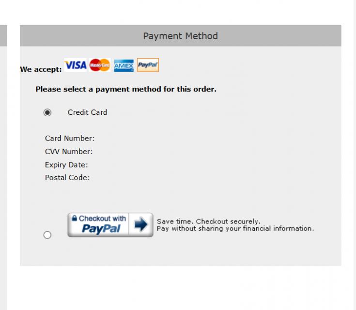

I really really want to use OPC on my site, but having an issue with the square payment module and free shipping only. I looked through this thread and saw where someone else had a similar problem, but doesnt match mine... so here I go:
Dev site using:
PHP 7.1
Zen 1.5.6c (includes square code)
Mods so far are:
Slider on main page
Colorbox
Testimonials Mgr
News Mgr
Issue: Square shows up, but I get no input boxes
Hoping someone can help me figure out what is going on?
Attachment 18624

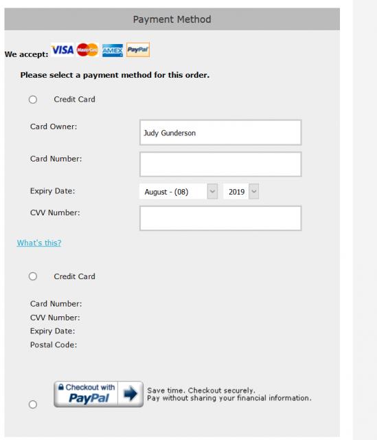

What template are you using, @stellarweb?
Do the input boxes show if you disable OPC and checkout using the "traditional" method?
Yes, authorize.net shows up fine, I checked that first thing. I have also tried different versions of php and that didn't help either. I wonder if there is a javascript conflict with some of the mods I have installed? Do you think it will help if I try disabling some of the mod js and see if that changes anything?
Attachment 18625
I was asking whether Square shows up OK in the 3-page checkout.
Saying that, have you copied /includes/modules/pages/checkout_payment/jscript_square.php to /includes/modules/pages/checkout_one?
