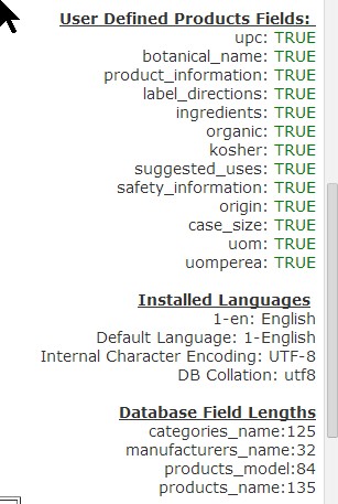

I created custom text fields using phpMyAdmin. I added the field names under Admin>Configuration Management>Easy Populate 4>user Defined Fields making sure to include a comma without any spaces between each field name. I then went through the steps to import the data from the newly created fields. EP 4.0 indicated that all of the records were updated without any errors; but, when I went into phpMyAdmin to confirm, I discovered that none of the custom data was imported. What am I missing?
FoodSourceDirect
1) Into which table(s) were custom fields entered?
2) When populating the configuration field was the v_ incorrectly included or was it correctly removed. Ie. products_id (correct) instead of v_products_id (incorrect)
3) Which import/export type was performed? (Btw, the field(s) should also export if all things are correct for the applicable data dump.)
If you are trying to export an additional field that is located in your products table and you are using EasyPopulate ver 4, that is not the way to do it. If you look in the admin panel, configuration, Easy Populate 4. There is a custom field text box. In that text box, enter the field name which appears to be products_price_w. Then on export/import that field will populatein both directions. If you need more than one field added, then separate the field(s) with a comma.
Thank you. I went to admin panel > config > EP and added products_price_w. It worked perfectly :)

Hi MC:
I imported the data into the product table.
The "v_" was not included.
I used the FULL-EP template. The CSV file that I created and used was formated ( a ##############) of the FULL-EP "Complete Products (with Metatags)" under "Product & Pricing Export/Import Options:"
I have included a screenshot of the user defined fields as entered in the 1.5.3 ZC Configuration and a screenshot of the the fields as named and listed in the database. Not sure what is the best format to use, therefore I chose "TEXT" as the field type; since, all I am trying to do is provide additional product information for each product. BTW. I was able to successfully install TPP 1.10. I thought that I would import the data from the custom data fields and then try to figure out how to get TPP to show the custom product field data in tabs. So I need to figure out what I am doing wrong.
Attachment 14446Attachment 14447
AJ

Hi MC:
AJ
Okay, so two things still, after adding some datato atleast one product through whatever means you have (say myphpadmin) try exporting the data, modifying what needs to be then importing it again.
In parallel with that, what is the filename that you have for your current import file? (Don't need the path, just the filenaame.)

Been a while since I have looked through the various exceptions, but as provided that filename is not the format expected by EP4 to process the records into the database. Take note of the filename format of the exported file. When you said that one "imported" from what was entered in myphpadmin, did you mean that one exported? (From database to the csv file.)
Hi MC:
This is weird. I looked at the file that I exported from Easy Populate 4.0 and noticed that a v_ was inserted at the beginning of each of the column header names of the custom product fields. Did phpMyAdmin do that or did Easy Populate? Could that be the problem.?
FoodSourceDirect
Hi MC:
The headings of the exported csv file are prepended with v_ and that same prefix is expected upon upload. Unfortunately, those that become familiar with that information, tend to also include it in the customized list. So there is no problem that it exists in the csv file and is an indication that the code is processing.
Still unsure if your issue has been resolved. The only other thing I can think of at the moment if it hasn't is that the database manipulated in myphpadmin is not the same as referenced in the admin/EP4 which wouldn't be unheard of when bouncing back and forth between the variious locations.
Attachment 14450Yes. I typed information into the "product_information" custom product field from within phpMyAdmin. Then under Product & Pricing Export / Import Options, I chose Complete Products with Metatags to export my products. A look at the exported file revealed that the data that was typed using phpMyadmin was exported.

[FONT=Verdana, sans-serif]The attachment is very interesting.[/FONT]

Interesting indeed, (if I was able to open it). I highly suggest you rename your admin directory right now. It is included in the posted link. :/
Hi MC:
Something you said gave me a tip. I changed the beginning of the name of my csv file from FULL to Full and pre-pended the custom product field names in my csv file I created with "v_", redid the upload and it worked... Thanks
renamed. Thanks for the heads-up
FoodSourceDirect
Hi MC:
Welcome, though the thanks should go to Chadderuski as it is has been his suggestion to export first to see how things look and respond before trying to upload. Also to back up back up, back up before making changes to the database. :)

someone please help,i transfer my website from one sever to other,the EP is not working,it only show some information,but there is no area for download,upload ,please refer to this pictureAttachment 14530
I don't know what's going on and how to fix it.
e-standard
Attachment 14530
Two things come to mind. 1. Check the error logs directory because of a partial screen display (ZC version < 1.5.1 is cache directory, >= 1.5.1 is logs directory)
2. Select the uninstall link on upper right and then the install option that will become available.
If that still doesn't work, then would help to know/understand how the transfer was performed and other related issues.
Where to see the error log?in which file?
I have tried uninstall and install,even upload the new file,not working.
I use cpanel backup the main dir file and import to the new sever,do not make any change on it,btw,the zencart version is 1.3.9
Here is the error code
[19-Sep-2014 07:02:05 UTC] PHP Fatal error: Call to undefined function mb_internal_encoding() in /home/estanda1/public_html/1246/easypopulate_4.php on line 315
problem solved,i did not install mbstring on the sever
e-standard
Good work figuring it out. That seemed most likely, but easiest to identify by following the suggested reviews.

I've been using EP4 for a while now, great utility.
I've just uploaded a new line of products where the quantity is implied, and so I want to turn the off the Quantity box in the product listing. Is there a way to toggle the Products Quantity Box Shows option in the products listing using EP4?
Many thanks for any suggestions
John
jrobbo
John
Not by default, but it is easy to add...
In the admin->configuration->Easy Populate 4 there is a field (User defined products fields) to add additional fields for export/import. Fields associated with the products table can be added into this list. The fields should be identified as they appear in the products table separated by commas only (for more than one field). So for this case, if the products_qty_box_status field is listed then when it is set to zero (0) it appears that the option to choose a quantity for a product will be prevented.
One of those things that not everyone uses, so it seems that it was left off as a default like option, but is something still possible.
Well that turned out to be a whole lot easier than I thought it was going to be! Thanks very much @mc123456578 for the excellent reply, works like a charm.
John
jrobbo
John
Quite welcome, wouldn't have been possible without the rework done by chadderuski, all of the feedback of the users and the work of those leading up to this. :)
