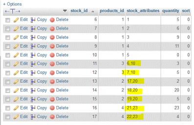

I have a feature request, we want to have the stock levels show up in the dropdown list. All our products have more than one attribute, so some sort of ajax cascading options system.
My client loses a lot of sales because things are out of stock and we would like to be able to show customers before they hit the cart.
Ok just a tip for anyone, if you duplicate a product in zencart it doesnt duplicate the stock by attributes settings so thats a way to delete them all. I cloned the product and then deleted the original product.

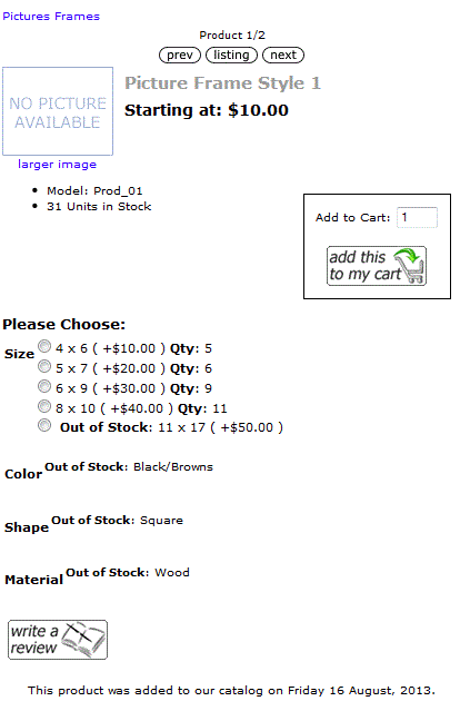

Hello there.
i'm using 1.5.1 . stock v.4.0
i installed the stock by attributes ad don and everything is good.
the only problem is that the user see only the total count of the attribute.
my Q is :if there any way to display the attributes like this:
large 22 in stock
small 22 in stock
right now it show 44 in stock .

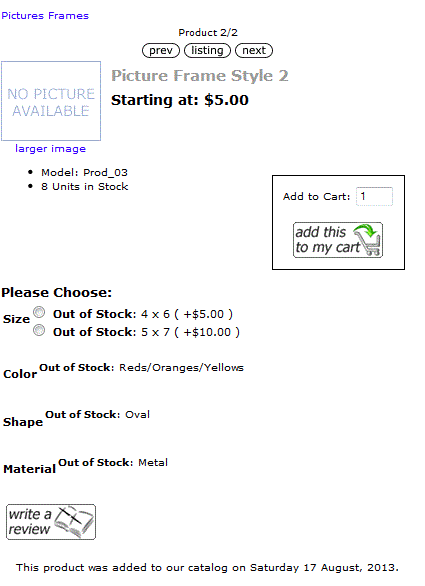

Hello people.
How can i set easy populate for this mod?
and also i can i show my customer the stock level not as total item?
thanks .
last problem ,please somebody....please.
i set up stock by attribute that working great thanks.
now the problem that i have is that:
out of stock massage is not showing only for product with no attribute (product with attribute is working fine)
i hope somebody will understand my problem and help me.

I just installed stock_by_attribute_1.5.1.1 on a fresh install of Zen Cart 1.5.1.
Everything seems to be OK, except on the product display page. When a product attribute/variant (in this case size: 5 x 7), is Out of Stock, it shows out of stock but it places 2 instead of 0 for Qty(quantity). Which seems to be coming from the previous attribute (4 x 6). Following is the pictures of what I see.
Attachment 12902
Has any one encountered this problem?

Kevin205
I just installed
places 2 instead of
Hi, Thanks for spotting this, I have a fix.
You can do either of the following:
1. Replace the "includes\modules\attributes.php" file with this one Attachment 12915
or
2. If you have made changes to the 'attributes.php' file then add this code on/or about line 118 before the if() "$PWA_STOCK_QTY = null;//initialize variable"
//add qty to atributes based on STOCK_SHOW_ATTRIB_LEVEL_STOCK setting
if(STOCK_SHOW_ATTRIB_LEVEL_STOCK == 'true' && $qtyeachoption->fields['quantity'] > 0 ){
$PWA_STOCK_QTY = PWA_STOCK_QTY . $qtyeachoption->fields['quantity'] . ' ';
// END "Stock by Attributes"
I will add this to the next version I upload, currently trying to get pagination working on the entry page so that a smaller selection of product is displayed at one time.

FYI: Following pictures displays what I see,
- when I add inventory to the size from the mod.
Attachment 12922
with the following settings
Attachment 12924
- when I removed the second attribute id from the stock_attributes
Attachment 12923
