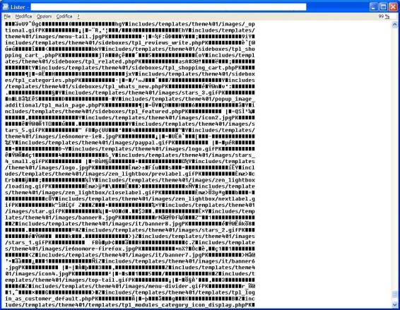

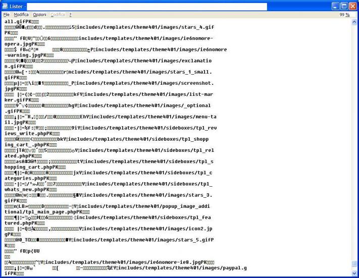

Dear All,
I think I've found the problem, but at this point I really don't know how to handle it correctly...
I've tried to optically compare the two files I got in different modes (see two messages above) with Notes and here is what I've found:
Attachment 12129
This is the one I've created on the server and downloaded later, the one I can correctly open...
Attachment 12130
And this is the one I downloaded from the BackUp ZC webpage...
I guess I made some errors with collation changes to UTF-8 in within the website...
Just a quick opinion: since 99% of the changes involved the DB and only 1% PHP files, do you think this might be related to some DB contents, or is BackUp ZC completely indipendent from the DB contents (as I guess) ?
Thank you...
