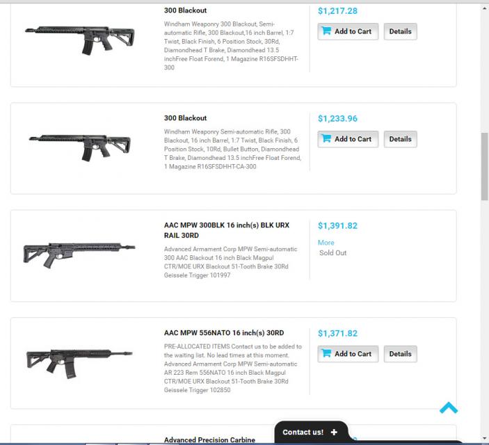

Re: Ajax Back In Stock (re-written version of Conor/Ceon's Back In Stock Module)
First, love the script. I have been using it back when Conor first made it and it is still running on an old site. I have the new version installed on my new site but I am having a few issues. First, I would like to display it on the main product listing page but do not know what file it is contained in. I am looking to replace the "sold out" text. please see image:
Attachment 16152
Also, the request to be notified works great (I see the entries in my db), however, I cannot get the back in stock email to run. I have my cron set up to run every 10 minutes but something is not working right. I have it set up just like I do on my old site just a new file path. Any ideas?
I do get this in the error log:
[23-Mar-2016 08:15:44 America/Denver] PHP Warning: PHP Startup: imagick: Unable to initialize module
Module compiled with module API=xxxxx525
PHP compiled with module API=xxxxx226
These options need to match
in Unknown on line 0
Clint
clint6998
Hi, do you have read the readme files from 4.6.2?
Make change of the
/includes/templates/your_template/common/tpl_footer.php
/includes/functions/functions_general.php
And since all of us are using/bought skin from 3rd ..
If above two of files you following by the readme.html
Then it is time to look on your skin files and with CSS (Manual add/change as need to match your skin)
I am on progress the same thing like you on my skin
Here what I am find
/includes/modules/your_template/product_listing.php
/includes/templates/your_template/templates/tpl_modules_products_featured_listing.php
/includes/templates/your_template/templates/tpl_modules_products_all_listing.php
/includes/templates/your_template/templates/tpl_modules_products_new_listing.php
look on the $buy_now (Base on my template, but your maybe not same)
And about the error log look like your host or your server haven't install Imageick well, why not just using PHP-GD more easy for your life.
I'm rebuilding our server from scratch using Zen Cart V1.55f, having used CEON Back In Stock Notifications for years. I've installed Ajax Back In Stock 4.6.3 (the latest version at the time of writing) and I really like it.
There is one small issue on our test system that I haven't been able to resolve. On the product info page, I click on the BIS link and the fancybox appears with the description of the product and its image. Very nice touch and it looks great. However, when I do the same on the product listing, the fancybox appears but there is no product description and the image is the "No photo" image. Filling in the details and submitting them still results in a subscription e-mail and the description and image in that e-mail are correct. Therefore it is a cosmetic issue but still one I would like to resolve.
Any ideas where I should look?
P.S. Using PHP 7.1 on the new server, if that makes a difference. I can't see anything in the logs.
The product listing pages use a single game box the image, name, and product are populated upon clicking the link. My guess is that the template being used isn't using the same classes as what it's set up for.
