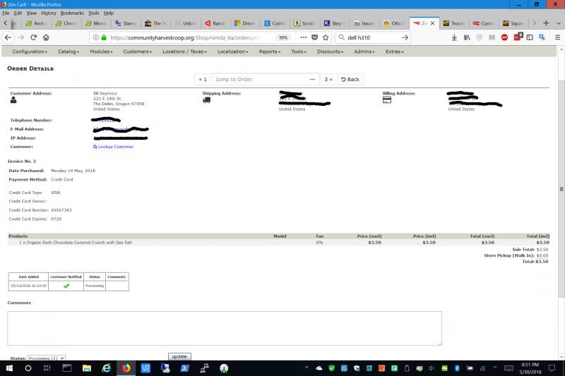

You didn't say whether this was triggered by a customer purchase or if it was from an Admin attempt to look up an order paid by Square.
This error is being logged when viewing an order in admin.
Address and country details all appear to be correct.

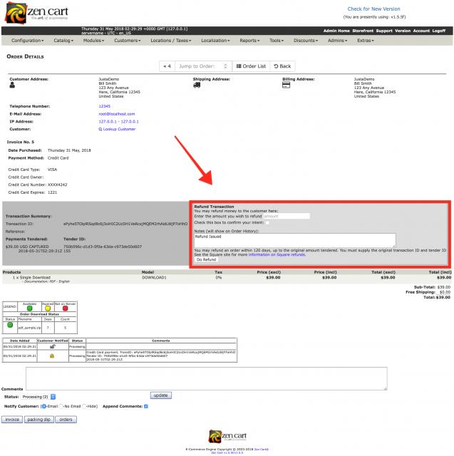

In order to issue an refund you must go through the Admin. Go to the customers order you should able click on a button to refund.

Yeah, I'm not seeing that entire middle section.
Attachment 17882
Re: Square Payment Module for Zen Cart [Support Thread]
It seems that the transaction id being returned from Square is longer than it was when we first started storing those responses in order for this admin refund feature to "find" the detail.
Version 0.94 and newer will detect and fix the storage for future transactions. Unfortunately not able to lookup prior transactions between when Square changed it and when v0.94 fixes it. (older transactions prior to the change should show up for refunds fine, if they're within the allowed # of days where refunds are permitted)
You can apply the fix yourself by going to Admin->Tools->Install SQL Patch
and pasting in the following:
ALTER TABLE square_payments MODIFY transaction_id varchar(255) NOT NULL;
This will allow future transactions to be remembered and the refund option should show again.
