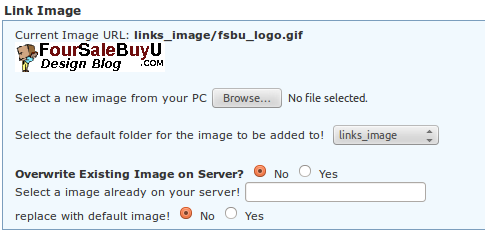

Sorry I spent so much time getting back on the image upload... found while sortting out a new install that I had changed mine so much that it didn't match the download version anylonger. Had to weed out what should be a simple switch out for you... Back up and test to make sure I didn't miss something...
The page is rearanged a bit so I could get the form to take enctype="multipart/form-data" and work right.
Attachment 14171

Looking at the rendered html.. it's completely different then what it should be.. check to see if the page was fully uploaded and not changed.
The button code is
<br class="clearBoth" />
<?php if (BOX_DISPLAY_SUBMIT_LINK == 'true') { ?>
<div class="buttonRow forward"><?php echo '<a href="' . zen_href_link(FILENAME_LINKS_SUBMIT, zen_get_all_get_params()) . '">' . zen_image_button(BUTTON_IMAGE_SUBMIT_LINK, BUTTON_SUBMIT_LINK_ALT) . '</a>'; ?></div>
<?php }else{ ?>
<h2 class="buttonRow forward">Sorry, We are not taking Links at this time.</h2>
<?php } ?>
<div class="buttonRow back"><?php echo zen_back_link() . zen_image_button(BUTTON_IMAGE_BACK, BUTTON_BACK_ALT) .'</a>'; ?></div>

Okay, the problem is in tpl_links_default.php line 118. It has the following code:
<div class="forward"><?php echo '<a href="' . zen_href_link(FILENAME_LINKS_SUBMIT, zen_get_all_get_params()) . '">' . zen_image_button(BUTTON_IMAGE_SUBMIT_LINK, BUTTON_SUBMIT_LINK_ALT) . '</a>'; ?></div>
swapping the above code for the code you supplied fixed my problem. For those clicking on my live link listed previously, you will not see the problem since its now been fixed.
