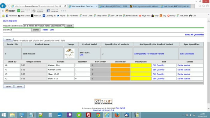

Hi, new to ZC so on a learning curve here, but managing. However, a question re this plugin (v 1.5.3 for ZC 1.5.1). Is there an up-to-date instruction guide on how to use it? or can someone explain what the 'Custom ID' field is all about?
Mike
Mikeondraco
Mike

Many thanks for that, now understand. I think in my implementation I will not need to use it.
Another question, this is probably a setting I have missed somewhere. The plugin is working OK and I have 'SBA Show Stock Level on Product Info Page' selected true and the quantities are showing against the various variants. However, for variants where there is no stock, it is showing the 'Quantity of all variants' instead of 0. If I try to add an out-of-stock item to the Cart it comes up as out-of-stock, so it's just this displayed figure that is wrong. Any suggestions ?
TIA ... Mike
Mikeondraco
TIA ... Mike

Just been playing around and found a fix. If I enter a quantity of 0 against a variant it does not show up in the table. If I set a quantity >0 then it does. If I then edit the quantity in the table to 0 it remains visible and works correctly in the cart
Mike
Mikeondraco
Mike

I was adding them all in exactly the same way, entering the actual true stock levels. However, as you say, a quantity of 0 will not add the variant, so a quantity of 1 has to be entered to start with and then edited in the table.
No problem, as long as I know the sequence :smile:
Mike
Mikeondraco
Mike

Apologies if I was sounding flippant, my site using Zen is still under construction, thus nothing seen live by customers, etc.
The reason I want to add variants with 0 stock level is so that customers will be able to see all variants that can be available, whereas if not shown on the product screen, then that variant is not obviously available.
As I said above, still very much under construction as I am working my way through learning the package. If you want to see what the result of the above is on my product screen is have a look at:
http://dracocrafts.com/dcshop/index....&products_id=1
and look at the Size drop-down box.
Entering a stock level of 1 to get the variant into the product table and the subsequently editing it back to 0 would have no consequences on a live site either. Until the 'Sync Quantities' tab is selected (or Sync All Quantities) then the live database is not updated and consequently the new variants/quantities are not available to customers.
If there is a 'fix' for this then I would be happy to incorporate it. Personally I am not a smart enough coder to know how to fix it myself, so this work-around will be fine for my implementation in my store.
Mike

Did discover that the reported quantity in cart is not correct, which is something else that will need to be addressed... But at least up to the point of adding to the cart, there is nothing preventing adding quantity that were designated for a variant even if the total variant quantity exceeded the synchronized quantity. (That said, there also is no "edit" for the synchronized quantity, either it is the total of all the variants or it is off because the variants have been manipulated outside of the cart's "normal" process.)
There will be a fix for the inability to add a variant or combination of variants with a quantity of zero, just have to find the correct coding for when the value is zero as I remember there is a "trick" to get around the result that is being seen, but I can't remember what it is off the top of my head.
Sorry, to answer your specific question, I was populating one variant at a time. Eventually there will be 2/3 variants per item in this category, but not got that far yet.

Ok, been playing with it tonight, but do not seem able to get the correct results.
The example is Colour: Pink and White, Size S & L. I have 1 each colour in S, but only white in L.
I added the two variants to the product checking the All-Attribute-Combo and quantity 1 for each Option Name. In the table presented I have four variants shown all with qty 1 as I entered. However, there is no way (that I can see) that I can input that I only have the L size available in White, I can either have qty 1 or 0 in the table against that value, which shows up in the catalogue as 1 each colour or out-of-stock in both ?
Attachment 15052

Yup, incorrectly entered...
On the screen for entering new variants, should see something like:
Colour: (dropdown)
Both dropdowns need to be identified as All-Attribute-Combo at one time...
So would see:
Colour: All-Attribute-Combo
Then in quantity, enter the desired quantity (0 is a start so that nothing can be purchased of these).
The result on the screen you show should be similar to below where I have shown a single variant that has multiple attributes applied:
X | 5-50-52| colour: Pink (next line) Size: 12-13 | 0 | 0 | blank | blank | Edit Quantity | Delete Variant
You'll also need to delete those four variants... They are incorrect for the purpose of multiple attributes and will likely provide unusual results...
That's it ! - I need leading by the nose you see :blink:
Many thanks yet again ... Mike

I am not real familiar with SBA - so will start this off by saying... pardon me if I ask a really STUPID question! LOL
I have a customer that has a very old version of zen cart that we are trying to upgrade. She uses SBA, Dynamic Dropdown, and an Atrribute Image swap.
I have done the upgrade to 1.5.4 using the latest SBA code on github. The latest SBA code appears to have Dynamic Dropdown built in from what I can see.
My problem is that on her current site, if you click the first dropdown, Say... Long Sleeve Tshirt, then click on the next dropdown, EG: Color, it will only show the long sleeve options. This, to me, would be the "Dynamic Dropdown" function.
In the NEW build, it shows ALL the attributes for the "product", instead of just the Long Sleeve T-shirt.
Here is a link to the new build:
Here is a link to the original site
I have gone at this every way I know how... merging code, not merging code, and it just doesn't work. :ohmy:
Is there something that I am missing? Or does Dynamic Dropdowns just not work "out of the box" with the new version of SBA?
Thanks so much for any assistance you can give me!!

Correct, the version that is in the branch mc12345678_sba154 has dynamic dropdowns incorporated as provided via download from this site. There is a new selection available in the admin that was not a part of the original code that was put together to specifically work with this version of SBA. That said the new site does not appear to have the sequenced dynamic aspect active...
There are a few things though that need to go together to get the desired result(s).
The code that was a part of your previous version likely could be ported to this one and continue working; however, to use the version created here and active upon installation requires the product variants to be entered as discussed over the few previous pages where each entry of a variant contains all attributes applicable to that stock tracked quantity.
To best try to resolve, would help to know what the settings were/are for the old site in the dynamic dropdown configuration area. Both for multiple attributes as well as single attributes.
Then to also know how the variants are setup for example on the product presented above.
In looking at the current admin (version 1.3.8a) and the new build (1.5.4), I do not see anything that says anything about Dynamic Dropdowns either under Configuration or Catalog menus.
When I use the Search Configuration on the new build, I see
Enable Dynamic Dropdowns 2
Product Info Single Attribute Display Plugin multiple_dropdowns
Show Out of Stock Attributes True
Product Info Multiple Attribute Display Plugin sba_sequenced_dropdowns
Mark Out of Stock Attributes Right
Display Out of Stock Message Line True
Prevent Adding Out of Stock to Cart True
SBA Number of Records to Displayed 25
On for Multi-Attribute Only
Does that help any?
