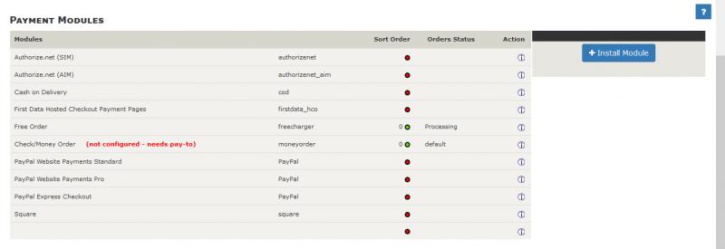

I've just done a clean install of v1.5.7d and added the Stripe payments plugin. Everything seems to be working except the Stripe payments module. I've unzipped the files and uploaded them to my /(storename)/includes/ but when I go to Admin - Modules - Payment there is no way to install Stripe. A blank line appears where Stripe should appear, and when I click on the blank line and then on “+Install Module” it goes to the installation option for Authorize.net and nothing else happens.
I've installed Stripe in the past on an older site and it worked just fine, so I thought I knew what I was doing, but I guess not. :( What am I missing??

I'll try to attach a screenshot of Admin - Payment Modules, see the blank line at the bottom where stripe should be.
Attachment 20003

I get the following error messages in the log files whenever I try to do anything related to installing the Stripe module.
There is no file modules.php in my /home/[user]/[storetestURL]/[admin]/ directory, which the error logs refer to! Maybe that's the problem?
[26-May-2022 08:48:50 America/Los_Angeles] Request URI: /[admin]/index.php?cmd=modules&set=payment, IP address: 205.211.113.128
#1 require(/home/[user]/[storetestURL]/[admin]/modules.php) called at [/home/[user]/[storetestURL]/[admin]/index.php:11]
--> PHP Warning: Undefined property: stripepay::$sort_order in /home/[user]/[storetestURL]/[admin]/modules.php on line 251.
--> PHP Warning: Undefined property: stripepay::$sort_order in /home/[user]/[storetestURL]/[admin]/modules.php on line 257.
--> PHP Warning: Undefined property: stripepay::$sort_order in /home/[user]/[storetestURL]/[admin]/modules.php on line 274.
