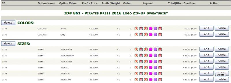

BTW - I can get the 1.5.4 code from github to show the attributes .... but the problem is that it shows ALL of the attributes stock - even if there is zero stock for the option value. I was HOPING this newer "combo" code would rectify that. If not... then I can switch back to the 1.5.4 since I know it works and the combo one apparently isn't working.
Do other attribute types show?
If so, then it would appear that the site is missing a few keys that would have been removed from sql code of other plugins. The install evolution should address/correct that issue. Other attribute types that would likely be affected would be text and file upload. Try a radio button and see if the attribute types come back. Should be able to provide the sql statement needed if the issue persists.

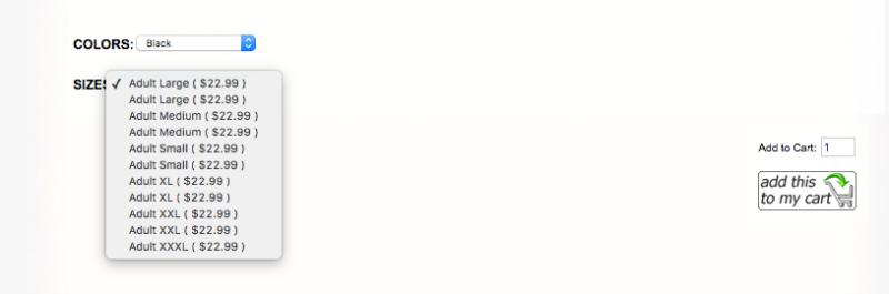

Changing it to checkbox makes the attributes show up.... but unfortunately ALL the option values show up..... not just the ones that are in stock for that item
See this one:
http://www.elkkids DOT com/store2/index.php?main_page=product_info&cPath=28_2&products_id=120
Only one color is in stock.

Since other attribute types show on screen, but the classic dropdown doesn't, this seems to confirm my suspicions of a few keys being removed from the database which well... doesn't happen as much now-a-days and is reversed by installation of ZC 1.5.5 and/or running the install of this plugin.
Doing so will/should execute the query(ies) below to restore the missing attribute types (any existing variants will remain untouched, but for now the SBA configuration settings will get reset to "factory default", then after the install, you will want to change the option name type to the added SBA basic/simple dropdown to get the desired results:

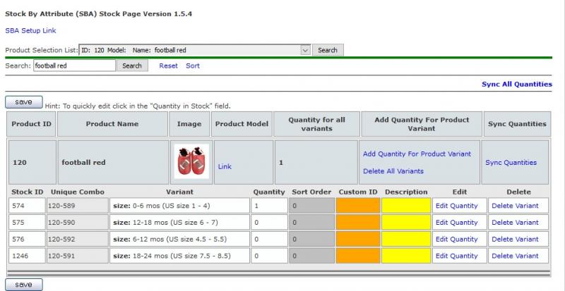

Does the potteryhouse version get the "out of stock" attributes not to show up in the dropdown - like the older version of SBA used with 1.5.0?
For some reason the combo version still shows all the option values - marked "out of stock", but would prefer it if any option value is not in stock that it just doesn't show up. Am I missing a configuration somewhere?
I have to go back and 1) look at the current code and 2) look at changes that were made. For some reason I recall a constant being used to do that, but it was based on the store as a whole and I thought I didn't see the relationship. I say this because in navigating the demo site I saw that product were desired to remain displayed even if the product was out-of-stock. Because of that, SBA would require a separate setting than what the store has. Ie. Store allows out-of-stock product to be displayed, while SBA product option listings would hide the display of out-of-stock attribute options.
Such capability already exists when using dynamic dropdowns for the applicable quantity of option names (attributes). Thing is I haven't done much if anything to make sure that the multiple attributes options settings (to be used for product having a single option name) is fully functional. I saw problems with it early on but since potteryhouse had a functional version didn't see the need to modify that code especially if someone already had it reworked and transferred their version to their new/upgraded site.
In my tests yesterday (not 100% exhaustive) I came across the same issue you described that the attribute options continued to display even when the attribute option was out-of-stock. Now, that said and because the sql query posted here was run instead of the install, it appears that some settings are not in place/set to prevent selection of an out-of-stock attribute. What was seen was that an item that is out-of-stock could be selected, and an attempt made to add to the cart which would guide the individual to an empty cart without a notification (issue that existed in ZC 1.5.4)
On the 1.5.0 site that I am upgrading... the "not in stock" attributes don't show up - and if there is just one attribute left that has a stock amount, the item shows up as a radio button instead of a dropdown.
I definitely need this capability, because my client is NOT going to be happy seeing the "out of stock" ones displayed. Any suggestions on what I should do from here?

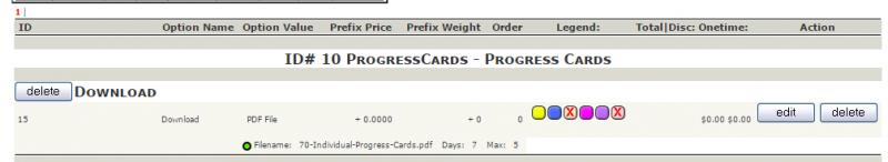

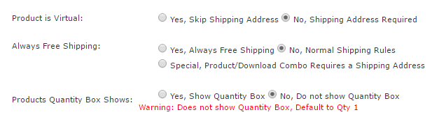

I've got SBA Version 1.5.4 for Zen Cart Version 1.5.4 and it's been running fine for months.
Today, I've added a downloadable product but can't add it to the shopping cart. I get 'Your shopping cart is empty'. Error log says:
PHP Warning: Missing argument 1 for queryFactoryResult::__construct(), called in /home/ACCOUNT_NAME/public_html/includes/templates/herbally/templates/tpl_modules_attributes.php on line 28 and defined in /home/ACCOUNT_NAME/public_html/includes/classes/db/mysql/query_factory.php on line 550
I've checked the product is set-up correctly for a downloadable product.
I was a little unclear if the option value needed to get set to Read Only or not, so tried both.
Suggest trying one of the updated versions of the file which can be found in the main install. The file in question is as reported: includes/templates/YOUR_TEMPLATE/templates/tpl_modules_attributes.php. That file was updated in April of this year to address that particular error. At least as things appear in the history for that file and that line number... Though not entirely sure how that error plays into the adding of the product to the cart. Further, think would need more information about how things are setup in order to advise further on a downloadable only product, especially with having an older version of the file(s).
I had been using the more recent version from the ZC 1.5.4 series. I tried the 1.5.5 version but same problem.
Attached are how I've got the product set-up.
My confusion is this is not an SBA attribute, so it should just ignore it. I feel like I missing something that expresses this.
Attachment 16645
Attachment 16646
Attachment 16647
Well, I would actually say that something else is installed that is interfering.
Reason is, the error shown on the previous post at line 28 of includes/templates/YOUR_TEMPLATE/templates/tpl_modules_attributes.php for the version of the file between April and about June of this year began passing the database credentials for generation of the queryfactoryresult class variable. This only became necessary in ZC 1.5.5 because of changes made to includes/classes/db/mysql/query_factory.php. In previous versions of ZC, that variable was not needed, and in fact if it was passed to the function, would be ignored by a default install because it would be an excess parameter that is/was not handled by ZC and therefore would not cause a problem. If though, that zc file were replaced by some other plugin, the additional variable may become necessary and if the template file of the current set was used, it would attempt to pass it properly and not through an error.
That said and as questioned, the line 28 code would only be run if the product for any of many different reasons was not to be displayed as a SBA tracked product, one that matters specifically to adding the product to the shopping cart is whether the products_id is listed at all in the products_with_attributes_stock table (all such entries appear in the admin control screen for SBA under the catalog dropdown).
Now, the other thing, which was an issue with ZC 1.5.4, is that there are error messages not pushed to the screen when there is a problem with adding product to the cart. Unfortunately I don't recall the specific work around that was necessary, but it may be addressed in the known issues with ZC 1.5.4. I do know that Ajeh had weighed in on the matter in one of the past/previous threads.
Beyond that, SBA doesn't evaluate any of the settings shown in the previous images in relation to non-SBA tracked product (products_id not identified in the PWAS table), so the issue would not specifically be with SBA processing, but instead something else that has been done/installed and that a file modified by SBA is showing the result of that other change.

I'm sorry if this has been asked already, but I'm getting duplication of attribute options on the frontend. Not sure why this is happening. I attached some images for you to check out. It also says GREY with any size is out of stock which is not how I have it set up. Let me know if anything is set up wrong. Running ZC 1.5.4. Thanks!
Attachment 16660
Attachment 16661
Attachment 16662
That type of duplication was seen with the version that was provided for download in the plugins area, but is corrected in the version discussed over the last several pages and is to make its way to the plugins once a few other improvements are made to expand its functionality and interoperation with other "typical" software.
Anyways, suggestion is to apply the software available at https://github.com/mc12345678/Stock_...butes_Combined. The files in the includes and admin directories should be applied first (merged as applicable), then to go into the sub-folder for your version of ZC and the files/changes also applied/merged with your template.
Well, actually it was a problem identified when trying to further it's use in more recent ZC versions and maintain operability of multiple option names such as you have setup. There are a number of other improvements made since that time as well. Not so sure that the particular issue would have been easy to find in the thread.
If anything, might have suggested reading through these last couple of pages to get an idea of the status of the software and what is going on to keep it accessible to those that wish to use it. :) the images were informative to at least identify my suspicions that it was occurring because of use of the older version(s).
Besides, if don't ask a question, may not ever find an answer. :)
Quick question, I've upgraded a site to the current version of this plug-in which solved some issues. Out of Stock attributes are identified as such in the drop down but are still selectable. Is having them grayed out and not selectable a setting I'm missing?
Difficult to answer without more information: product attributes, one option name or more than one, dynamic dropdowns enabled only for multiple attributes? What are the first three stock settings? Is it allowed for one to checkout with product being out of stock? If you were to say that the designation of out-of-stock wasn't present, then would suggest verifying the option name type.
You can't read what I'm thinking? Probably better than way....
Product has a single attribute, size.
dynamic dropdowns enabled only for multiple attributes: yes.
Check stock level: true
Subtract stock: true
Allow Checkout: false
The option is listed at out of stock, so I can select it, but cannot add it to the cart successfully. I get an empty cart. So the issue is just the missing disabled="disabled" on the attribute option.
