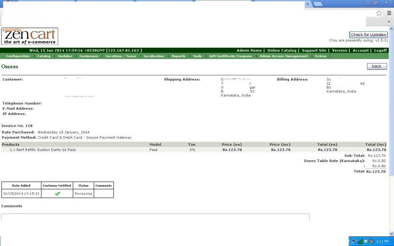

I did a trial order and the invoice looks like this:
Attachment 13666

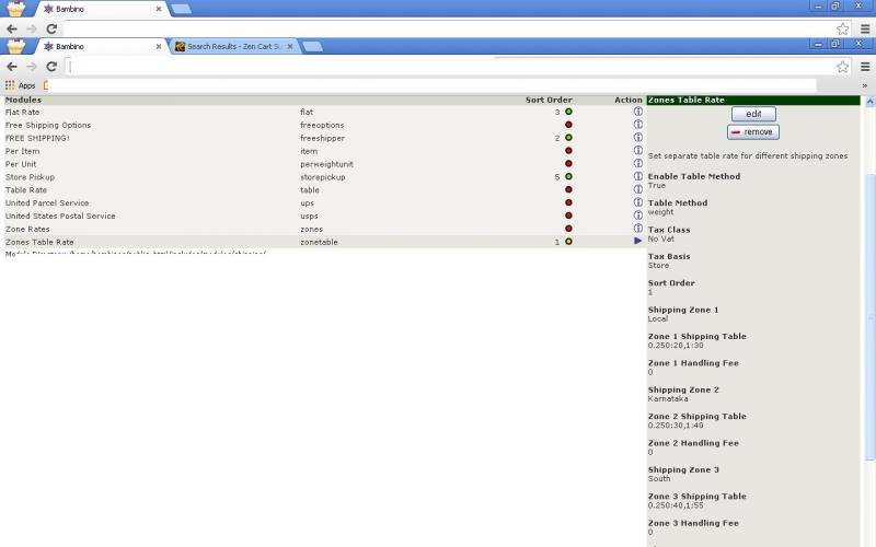

The Zone table pricing should have been 30 Rs ( shipping zone 2, Karnataka), but its 0. I am attaching the zonetable configuration again, for your reference :
Attachment 13667
Please let me know, where am I going wrong.
Re: Zones Table Rate Shipping Module
Can you post the settings on each of the Zone Shipping Table settings ... I cannot read them clearly in the image ...

OOps, pressed enter a little too soon.
Shipping Zone 1 : Local
Zone 1 Shipping Table : 0.250:20,1:30
Zone 1 Handling Fee : 0
Shipping Zone 2 : Karnataka
Zone 2 Shipping Table : 0.250:30,1:40
Zone 2 Handling Fee : 0
Shipping Zone 3 : South
Zone 3 Shipping Table :0.250:40,1:55
Zone 3 Handling Fee : 0
Shipping Zone 4 : Rest of india
Zone 4 Shipping Table :0.250:45,1:85
Zone 4 Handling Fee : 0

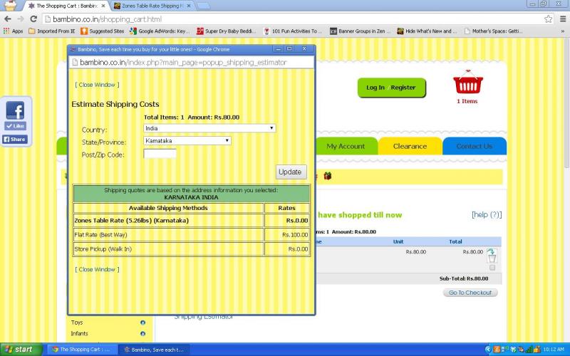

I did a dummy order again.
The product weight is 0.250 gm, as entered ( and double checked) in the admin panel.
This is what the estimator shows :
Attachment 13688
Also, regardless of the state I select, the weight comes to be the same : 5.26lbs ; and rate is 0
Not sure what's wrong. I am disabling the module as of now, and will keep the flat rate one on. Please advice

The problem is the definition for the Zone Rate:
Your definition goes to 1 lb and the quote is for 5.26lbs ... without a definition you get $0.00 ...
Try changing the Rate to:
0.250:30,1000:40
Does this now work better?
Also check what the settings are in the Configuration ... Shipping/Packaging ... on the Maximum Weight and the Tare Rates ... You said the Product was 0.5lbs and you are showing 5.26lbs on this product ...
