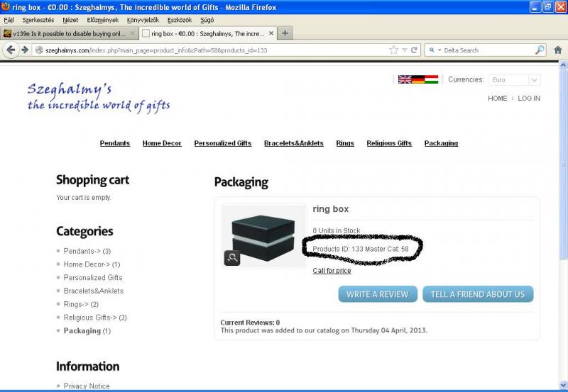

I'd have two more questions regarding this issue :
Attachment 12315
Why does it show this :Products ID: 133 Master Cat: 58 - How can i make this dissapear or prevent showing this info. in cas of other items later?
In case i'd like to have two or three other categories like this, for showroom only, do i only have to write the other category id's next to this one? Or doe it work differently?
Thanks in advance
Nandor
Attachment 12315
Thanks in advance
Nandor
I realized in the meantime that after this modification at all products the Products ID...Master Cat:... are shown,
no prices can be seen at the other products (the ones that should be add this to my cart) and under add to cart the word : details isnt translated when switching to german or hungarian. Unless i am mistaken the "detail" word wasnt even there before.
I dont know what all these three things have to do with this one modification....

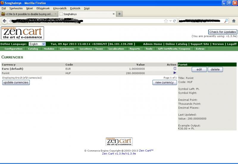

What are your currency settings for it?
Re: Is it possible to disable buying only in one category?
Ajeh
Did you mean this? :
Attachment 12327
Nandor
