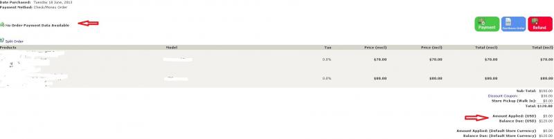

As part of a client's upgrade to v1.5.1, I'm installing Super Orders, Edit Orders and Ty Package Tracker in the site's admin (the admin install is a rebuild, not an upgrade). The store has a mixture of credit card, cod, paypal and moneyorder payments in the history.
Attachment 12724
When viewing an order that has shipped but was paid using moneyorder or cod as the payment method, the 'Balance Due' shows as the full price instead of 0. I also noticed that these same orders have the icon identified before the order details that reads "No Order Payment Data Available".
Is there any way to rectify this for the existing orders? There are a lot of payments using these methods.
Re: Super Orders v4.0 Support Thread
Attachment 12724
That's because these orders have no corresponding payment record in the SO payment tables..
You would have to run some custom SQL to add records to the SO payment tables for these orders.. For existing credit card and PayPal orders SO does generate the payment records for these payment methods automatically. SO doesn't do this for manual kinds of payment records because they do require some level of validation that the payment was received.. (It's how SO has always functioned)

I thought I explained why automated refunds were NOT implemented in the readme.. So let me write about it here..
First some clarifications:
The refunds functionality in the payment notification box (the "grey box") just above the product details section of the orders.php page is DEFAULT ZEN CART functionality.. It has NOTHING to do with Super Orders. The features in the payments notifications section differ if you are using Authorize.net versus PayPal, and if you want details on how these features work, they are outside the scope of the Super Orders support thread as this is default Zen Cart functionality which Super Orders DOES NOT touch.
Now that said, as you know Super Orders has a RUDIMENTARY accounting feature which allows a shop owner to "post" payments, refunds, and purchase orders against an order.. It DOES NOT interface with the payment processors in ANY way. Super Order payments are "automatically" posted when the payment is made via credit card (manual and via Authorize.net) or via PayPal. There is separate SUPER ORDERS code that creates these Super Orders payment records when one of these payment methods is used which works because there is code that can VALIDATE when a payment was received and create the corresponding Super Orders payment record. All other payment methods require that the Super Orders payment must be posted manually.
Refunds are different because the DEFAULT ZEN CART refunds functions in the payment notification box for PayPal is DIFFERENT than the DEFAULT ZEN CART refunds functions in the payment notification box for credit card processors like Authorize.net. PayPal refunds can be validated as there is data captured in the PayPal tables, refunds for other payment processors are not captured in a similar manner. Therefore when J Theed and others were working on Super Orders, we made a DESIGN DECISION to NOT implement automated Super Order refunds unless there was a means to do it for not only PayPal, but for other credit card payment processing modules as well.. This was done for 2 reasons:
- Super Orders should NOT be PayPal centric. It should be a tool ANY shopowner could benefit from and it seemed patently unfair that this benefit only be fully realized by PayPal shops.. PLUS there are shops who have BOTH PayPal and Authorize.net, and inconsistent functionality is NEVER a good design decision in any module.
- The process of issuing refunds via the payment processors (PayPal or other wise) is NOT automated, and so having one last MINOR step of entering a Super Orders refund record seemed like it was not a HUGE deal.. (and given that this is so-infrequently discussed apparently it hasn't been an issue)
the "solutions" posted by carlvt88 to enable automated Super orders refunds for PayPal are likely in one of the OLD Super Orders support threads.. or PM him directly..

Yup, is/was very clearly explained why it was not implemented; however, didn't see a discussion of what it was that was "missing". Ie. something similar to:
DivaVocals
one last MINOR step of manually entering a Super Orders refund record is necessary.
I think the above clarifies what is meant by automated refunds and the "difficulty"/near impossibility of implementing it across the board. I agree that the other discussion is of value to identify the thought process behind not implementing which all-in-all appears solid. But then again, incorporating the above requires another revision and the time involved to square everything away. In the mean time, the discussion clarifies things if not for others than for me. :) Thank you!
I believe I said it much more succinctly in the Super Orders readme:
The method required for generating PayPal refunds is different than the refund method for Authorize.net and Linkpoint.

** Also I noticed in the Super Orders configuration area, at the bottom it shows as Super Orders Version 4.0.5 ***
James
Re: Super Orders v4.0 Support Thread (for ZC v1.5.x)
PetleyJ
Thanks for that. Ran the uninstall sql file, then re-uploaded the base files and modified files and the same issue still occurs. I have then re-ran the uninstall sql file, the issue again still applies and the message at the top also stays there.
There are some hosts that do not properly support the auto-install functions.. I do not know why, and I am not sure how to fix this either.. Did you NOT see a message telling you that the YOUR_ADMIN/includes/auto_loaders/config.so.php was not deleted??
PetleyJ
James
Right.. so I missed updating one of the version numbers.. NOT relevant to the issue..
Hi Diva, no message appeared.
Everything else appears to work fine, just apart from the configurations and the message at the top.
James
Done some digging around and found it was a file from a previous version that was causing the issue.
Looked in administration/includes/auto_loaders and it was config.so.php that was causing the issue. Deleted that and it's fixed all issues.
PetleyJ
James
So, you may need to manually do at least the deletion actions of the auto install script to get it "installed" based on Diva's previous comment/statement that some hosts do not fully support the auto installer actions. In particular where the install script is still trying to install even though it would appear that the software is installed.
PetleyJ
Missing the configuration menu and the install success menu repeatedly re-appearing is quite the opposite of working fine..
Like I said some hosts don't work correctly with the auto-installer, and I do not know why..
I suggest rolling back completely.. and by rolling back, yes I mean restore your site from the backup of your site prior to installing Super Orders.. Run the uninstall script I am posting here, and start the install over, but AFTER clicking on an admin link to activate the install as the install instructions state, and BEFORE YOU CLICK ANYWHERE ELSE IN THE ADMIN, you need to MANUALLY delete the YOUR_ADMIN/includes/auto_loaders/config.so.php file to prevent the install from running again..
