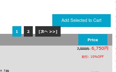

I am currently test Zen Cart 1.5.5a. It is a fresh installation. The template has not been changed.
As soon as the navigation display (page 1,2,3,...) in the product listing is shown, it overlaps with the "Add selected to cart"-button and the headline for the product list. The navigation block is also to be indented to the left.
I would like to remove the overlapping, but do not want to break the responsive design.

You might want to first clone the responsive_classic with lat9's Clone a Template. Then you'll have a copy you can play with and one to fall back on.
Next, take a look at the demo at http://netzencommerce.com/index.php?...index&cPath=22. Check to see if this is a fix for you. If so, you can use the mod in my sig to accomplish that look. We incorporated several "adjustments" into the color changing Mod.
BTW, the current mod has the wrong color template for the instructions. Version 1.1a is available now at http://netzencommerce.com/downloads/...anges-1.1a.zip. New version submitted for Plugins and available soon.
Thank you! It looks fine now.
