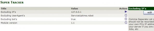

Am using 1.3.9h, and recenlty installed the supertracker to try and get some reports etc, but after a minor tweak in the tables of the database, I am still having a problem.
I was lead to believe that once installed, there would appear a box in the admin page, under configuration where you could set a few things up for this work, including adding your own IP address to make sure that it doesn't get recorded in the tracking.
However, when i click on supertracker in the configuration part, it comes up blank.
Any suggestions?
Did you install your SQL patch and the GeoIP.dat file? That could be a problem.
I didn't need to do any tweaking to any files of supertracker and I'm running a fresh install of 1.3.9h, except for some template and side box installs; everything is running perfect.
I've used Supertracker about a year ago, and never installed GeoIP.dat before. I don't know what its for, but I installed it anyways. It seemed to work without it just fine...
I downloaded the supertracker mod today and installed it today. no further tweaks or mods needed for 1.3.9h. as far as I can see.

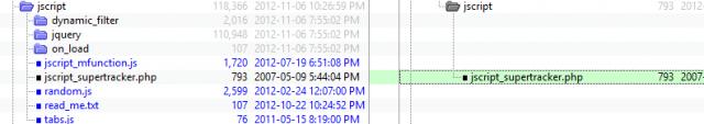

I know absolutely nothing about PHP, but the jscript file seems a little odd. All the other jscript files in the folder have a suffix of .js, whereas this one is named js_supertracker.php. Is this an error?
I'm running PHP 5.2.16.
Kim
I believe this error message is telling you that some other file is trying to call (or declare) the supertracker class for that page. Meaning that two different files are calling the same class (supertracker) for the same page. This is causing a conflict that can't be resolved, and so the fatal error (stop loading page) results.
To resolve the problem, I believe you have to identify all the files that are calling (or declaring) the class (i.e the code that's on line 15) and remove one of them.

I had tried it on my local machine (zencart v1.5.1). The main page couldn't be loaded when I added the jscript_supertracker.php to the site. When it was installed, I haven't saw the installation confirmation message, but the Configuration page was here.
Attachment 11393
Thanks Design75
I tested it on localhost and couldn't send you a link.
If I copy the jscript_supertracker.php to the site
Attachment 11395
The homepage couldn't be loaded
Attachment 11396
Below is the Page Source shown the stop point(from the firefox)
Attachment 11397
Code:<link rel="stylesheet" type="text/css" href="min/?f=/includes/templates/CPE02/css/style_dynamic_filter.css,/includes/templates/CPE02/css/stylesheet.css,/includes/templates/CPE02/css/stylesheet.css.back.css,/includes/templates/CPE02/css/stylesheet_random.css&1340329967" />
<script type="text/javascript" src="min/?f=/includes/templates/CPE02/jscript/jscript_mfunction.js,/includes/modules/pages/index/jscript_tabs.js&1340329967"></script>
What happens if you turn off minify?
no help.
Code:<link rel="stylesheet" type="text/css" href='/includes/templates/CPE02/css/stylesheet.css.back.css' />
<link rel="stylesheet" type="text/css" href='/includes/templates/CPE02/css/stylesheet_random.css' />
<script type='text/javascript' src='/includes/templates/CPE02/jscript/jscript_mfunction.js'></script>
<script type='text/javascript' src='/includes/modules/pages/index/jscript_tabs.js'></script>
page loading was stopped here
are there any debug-log files that could give us a hint? (found in the cache or log folder)
The error information. It looks like declare the class twice. Do I need change the code to include_once() or require_once() in some where?
Code:PHP Fatal error: Cannot redeclare class supertracker in H:\zencart15\includes\classes\supertracker.php on line 15
do a search for "class supertracker" in your fileset in the frontend of the shop. You probably have a rogue file somewhere where this class is also mentionted it should only be in \includes\classes\supertracker.php
I searched whole site by Xsearch. The "class supertracker" appeared in supertracker.php only.
I have send you a PM
