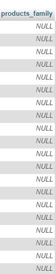

I added fields in the background, but the batch table still cannot be imported.
Is there a need to modify the program elsewhere?

If the field `products_family` exists in the product's table and the row contains the primary key that has been chosen, then import of that data should work or a message is provided about it not working.
To further test, I would recommend exporting one or more product that already have information in that field to see that it is exported and to provide a sort of example.
There is no other code modification necessary to support that in an otherwise functional system.
The import did not prompt any errors, but there was no value in the database.
Attachment 18794
If not I would expect some reason to be provided. Perhaps the CSV file is not formatted properly, perhaps the primary key used (default is products_model) is listed for more than one product such that an update is not going to the correct product. In this case would suggest changing the primary key to products_id.

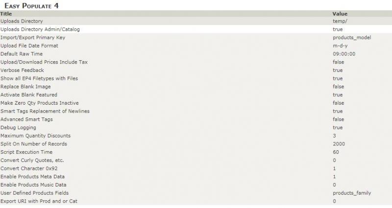

Is this set up correctly?
Attachment 18796
That looks correct to support import by products_model. Might suggest changing the primary_key to products_id, exporting then updating the products_family field for the items with the appropriate products_id. Note, that if you are wanting to add new product, I recommend the use of new_blank as the promary key. Then new product that do not have a products_id will be given one.

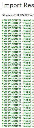

hmmm... I do have the primary key as model and entered the model as NEW PRODUCT! - Model: blank_new | | 1 | einsteins- | Colombian | Not just t | | | | | 55 | 6 | 0 | 25 | 1 | 1 | 0 | 1 | | | 0 | Coffee | Coffee^Pre | --none-- | 1 | | | | | | | | |
No product yet that I can fine. I will experiment some further. Thank you!

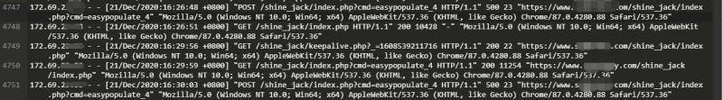

In the picture is my website log, can you see any results?
I also looked at the php log and the apache log and found no entries for easyPopulate.
Zen Cart 1.5.7
Easy Populate 4.0.37.10 - 02-08-2017
PHP 7.4Attachment 19336Attachment 19337Attachment 19338
The website log is an access log not an error log, so there is nothing there that helps resolve the issue. What about the first two lines of the import file? also, generally a way to evaluate operation of EP4 as compared to the file being imported is to export a file and then immediately import it again without editing... If there is no problem with that process then the problem is in the file that is attempted to be uploaded and imported after it was edited.
