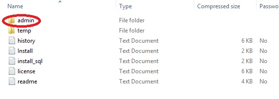

Skullman: Have you changed the name of the admin folder of the files to be uploaded to the name you created for your admin folder?
Attachment 11778

The version to use is EP v4 (NOT available in plugin area. Find the SUPPORT THREAD for EP v4, and Chad has put a link to GITHUB where you can download.
Like ANY plugin, the FOLDER/FILE integrity and hierarchy must match that of the zc installation on your server. So you do not just "dump" stuff... you need to make sure that if there is a folder called ADMIN in the plugin, then its contents must go into ADMIN (which will have a different name) on the server.
When you collect EP v4 and UNZIP it, chad will have a folder called ADMIN. If you OPEN that folder, inside it will be several SUB-folders and perhaps a few FILES.
THESE are what need to go into YOUR-ADMIN folder. As I said - it's not open heart surgery. Just make sure that all folders and their files get FTP'd to the correct LEVEL in the hierarchy.

easy populate does not show up in zen cart tool bar
please help
i installed easy populate admin folder in my admin directory.
the easy populate admin folder has the same name as my admin directory.
the files are all visible, within my ftp directory.
easypopulate_4_export.php (permissions 644)
i also installed the zen cart 1.3 extra files. (permissions 755)
in my stores admin directory
what am i doing wrong?
