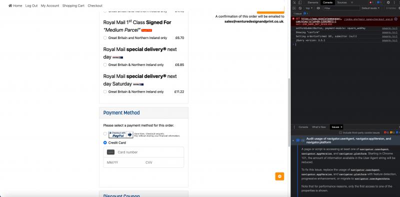

definitely a jquery issue. what version of jquery are you running?
i have it tested on 3.5.1.
do you know how to use the developer console? you should see an error there.
OK I will check in there. Might try and re-install the module actually. I am running 3.5.1 also.

carlwhat
the issue that @nick1973 is having is definite jquery related and/or OPC related.
he either does not have the checkout_one file i mentioned above or he is having a problem with this part of the code (from for_upload/includes/modules/pages/checkout_payment/jscript_square_webPay.php):
if (document.querySelector("#checkoutOneSubmit")) {
formButton = document.querySelector("#checkoutOneSubmit");
formButton = document.querySelector("#paymentSubmit");
i do not know what version of OPC he is running nor jquery; but if the first div with an id of #checkoutOneSubmit is not there, he will have a problem.
i was thinking about adding some console information in the event of problems right here. it has been on my mind of late.
and while i have TOTAL respect for drByte and lat9 for their contributions to this project as well as their troubleshooting abilities, i am perfectly able to provide support on a plugin that i developed and of which i am the most intimately familiar.
best.

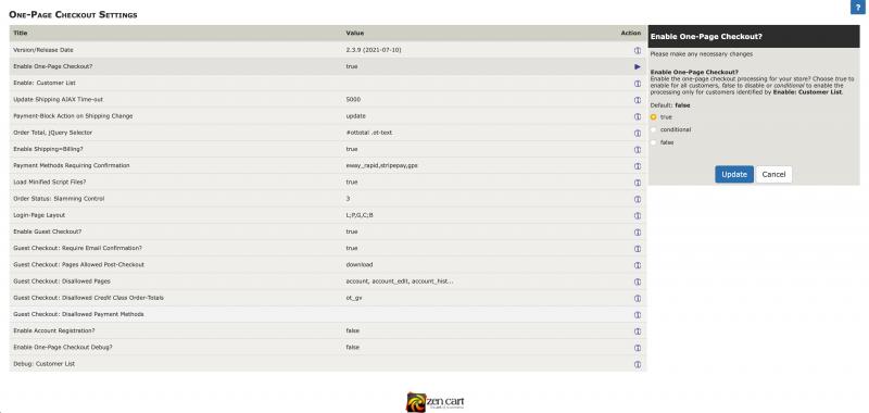

Ok, I have re-installed the module and I am still getting the same error with OPC
I've attached screenshots for a better understanding of what is going on. Hopefully you can view them. I also have a DEBUG file from OPC, but it contains personal details I don't want to publish here. So if that file would be help to you then I'll quite happily PM it to you for DEBUGGING.
Attachment 19964Attachment 19965Attachment 19966Attachment 19967
JQUERY is 3.5.1
PHP is 7.4
OPC is on version 2.3.9
Zen Cart is 1.5.7c
I have quite a few carts that are on similar set ups, using bootstrap and OPC so this is now beginning to cause a big problem for me. It is also causing an issue for my clients that are using Square and OPC. So I'd really like to find a solution to the problem I am having with the NEW Square Module and OPC ASAP if any of you are able to help me as I am losing money and so are my clients as a result of this issue with Square. I realise that you all give your time for these kind of developments at no cost to Zen Cart Users and Front End Developers, but this is a serious issue if it won't work with OPC. Not only that, I am still getting people that don't appear to be able to make payments easily even with OPC switched off. Some seem to be getting errors when paying and are switching to Paypal to make payments because they can't process payments using their card. So my thoughts are, something still isn't quite right with this module update. Although the version I had installed previously, might be different to the one I have installed from here:
JQUERY is 3.5.1
PHP is 7.4
Zen Cart is 1.5.7c
JQUERY is 3.5.1
PHP is 7.4
Zen Cart is 1.5.7c

I have just seen those images might be a little blurry due to compression. So if you want me Email them to you, please ask.

nick,
if you want help, i would suggest sticking to the topic. you can save your rants for somewhere else.
there is nothing that i see in your blurry screenshots that help indicate the problem.
i went through the trouble of creating an account on your website, but it seems that you do not ship anything to your own address or some other random address in the UK.
i would need to see the storefront where this problem is happening as i am not able to reproduce it on your own site due to your configuration. i did see problems in your OPC setup. see:
https://www.dropbox.com/s/4jbyt4pan5...19-01.png?dl=0
and
https://www.dropbox.com/s/cw7j5cfb45...20AM.webm?dl=0
i need to be able to get to a page that looks like this from your screenshot to help resolve this problem for you and your clients.
https://www.zen-cart.com/attachment....6&d=1650452517
best.

on the site you are trying to fix, i have confirmed that we are getting a response back from square. see:
https://www.dropbox.com/s/ubo8m9jjwb...50-25.png?dl=0
i have determined a potential problem with this file.
there is a new version of said file here for anyone who wants to test it:
https://github.com/proseLA/square_we...are_webPay.php
this problem seems to be confined to OPC.
