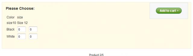

Re: Product Attribute Grid
http://eavisions.com/1.jpg
How to modify in such a way?
With two Multiple Quantity Box.
That would take some additional customized code (PHP and/or javascript).

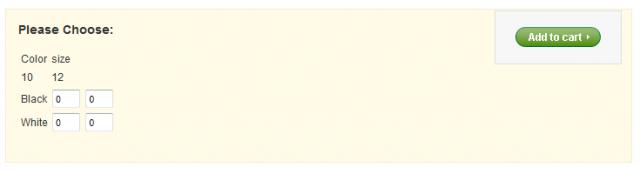

gjh42
http://eavisions.com/2.jpg
this modules default is above image when had two attribute.
how can i do like this :

hi all
I'm using zen-cart-v150-full-release-12302011
I have installed [ creinold_SBA5.0_alpha_version1.5_for_zencart_V1.5.0] and Pruduct Attribute Grid 1.1.2
they are working now, just display layout is not good, attach image as below, can anyone let me know how to edit the layout
pic1
Attachment 10651
pic2
Attachment 10652
the layout I need is similar as below pic
Attachment 10653
thanks a lot

Dear friends,
I really appreciate this module.
One thing I found questionable is that when I have only ONE COLOR and FOUR SIZES for product grid for an item, grid is incomplete.
Also the alignment for sizes are off.
If another color is added, the grid looks just fine as a complete grid. Nothing is off.
Here is the image:
Attachment 12338
You can see it at: http://www.jostarusa.com/half-sleeve...eve-p-145.html
Is there a way to complete the grid with only one color?
Jostar

DivaVocals
I've search the thread but don't see an answer for this. My apologies if it has been posted and I missed it.. I think I've found a bug with this mod.
See this product:
http://clients.overthehillweb.com/ha...erimeter-Large
This product has two option names: color & wig length. Color has two option values, and wig length has only one. Though BOTH attributes are set up with the grid type, when I add wig lenth to the product the attribute not only shows up as part of the grid, but also as a radiobutton too. I doubled checked that there is only have ONE option name called "Wig Length", and I double checked that there is only ONE 16" value added to this product.
This product had the same issue. To double check that this is indeed a bug, I added an additional option value to the wig length. Once I did that, the radiobutton disappeared.
http://clients.overthehillweb.com/ha...rimeter-Medium
Also I see that the issue is only a problem if there is one value on the right side of the grid. Products which have only one option value across the top of the grid do not display this behavior:
I could use some help as to HOW to fix this..:smile: Obviously the workaround is to add another option value to the right side of the grid, but I'd like to not HAVE to do this..
