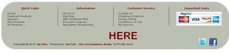

Hi, Thank you for the template which I am intend to use in my site.
My problem is that I've been trying to put a paypal logo between the links in the footer and the copyright line and have not been able to do it. When I try it gets positioned in a different place, other than where I want it.
If you look at the attached image, it is below the 'Important Links' link. And where it says 'HERE' is where I actually want it to go. Any suggestion would be appreciated. Thank you.Attachment 12087
Attachment 12087
You need to add your code to the incldues/templates/aberdeen_neutral/common/tpl_footer.php file and you can use css to position it.

Thank you. That's precisely where I added it. I tried several positions but my problem was that I could not find the exact place where to add it so it would fall in the middle above the copyright line.
The last place I tried was under: "<!--eof-navigation display -->" and it was when it fell under the 'Important Links' link.
But, since I was unable to figure out how to position it where I wanted, I decided to put the logo on a sidebar. Thank you.
I am happy that you figured out a solution :-)

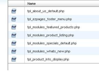

Sorry, I followed the path above and there is not a 'tpl_main_page.php file' at the end of the path. See attached image.
http://i638.photobucket.com/albums/u...psb01e1130.jpg

have a look in your template 'common' folder.

If the template is not in the template package then you can create an override for the file by copying the includes/templates/template_default/common/tpl_main_page.php to includes/templates/aberdeen_neutral/common/tpl_main_page.php

Hey, Im having an issue with the pages define not having a section to edit the "About Us" section? I have looked through all the php files and just can't find it? Am I missing something? I have skipped all through this thread and can't find anything? Have also read all the install files..
Hope to find an easy fix.
Cheers for the great looking template.
Attachment 13879
Re: Aberdeen Neutral Template Support Thread
THDMERCH
Attachment 13879
Copy the includes/languages/english/html_includes/aberdeen_netural/define_about_us.php file to includes/languages/english/html_includes
