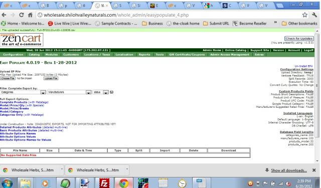

We installed the new version EP 4.0.22 - But the Admin "Easy Populate 4" does not show any new fields. According to what I read it should have a new field with true and false. I also updated by spreadsheet with the column name of v_products_upc - no success. So I changed it to products_upc - no success. On the Tools menu - it does show TRUE next to UPC. Did we install something wrong?
Product Short Descriptions: FALSE
Product Unit of Measure: FALSE
Product UPC Code: TRUE
Google Product Category: FALSE
Manufacturer's Suggested Retail Price: TRUE
Group Pricing Per Item: FALSE
Exclusive Products Mod: FALSE

We fixed the issue with the UPC - one of the directories didn't get uploaded to the site.
I was under the impression the ADMIN was also suppose change. I don't see any additional options listed in the ADMIN. Can you help with this?

Thanks Chadd,
Just to let you know I've used easy populate to upload over 6,000 products with success. I just can't get the UPC to upload.
You need to go to Tools -> Easy Populate 4 and click Un-Install, then click Install again to load the new configuration variables...
Chadd,
That fixed my issue.
Thanks for helping me.
Kevin

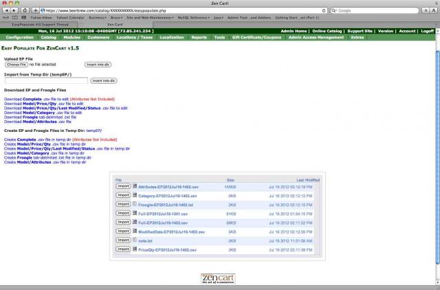

Good Afternoon-
I seem to have run into a problem while using easypopulate 4.0 I am no longer able to upload my spreadsheet from my computer to my website. This morning I uploaded all my products with no problem. I then attempted to upload my descriptions, at that top of the page it states that the file was uploaded successfully but there is no file listed below it shows that there are no supported data files. I tried to download another Complete Products spreadsheet to my computer and was able to do this without any problems I then tried to upload it back to my website without making any changes or opening it so it was exactly what I had downloaded. I was unable to do so. I noticed that my hosting company had decreased the file size I was able to upload so I spoke with them and they increased it upto 50MB I also tried uploading this file to both my main site as well as my subdomains and I can't upload my spreadsheet to any of my sites. Up until this morning I was able to use easypopulate 4 with no problems.
I am using zen cart 1.5
PHP Version 5.2.17
I am attaching a screenshot of the page
Attachment 10669

Good Afternoon-
PHP Version 5.2.17

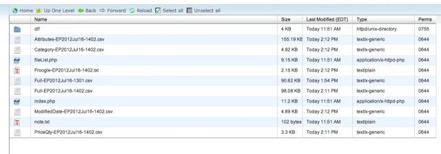

Make sure you have an extension on your filename and NO spaces in your filename. Also be sure to follow the file naming conventions.
Secondly, use FTP and check the contents of your remote folder. EP4 will only show files that are of a valid type.

Hi CybaGirl and Chadderuski
I have read all 44 pages of this forum and can still find no solution for my problem. I have sat here for nearly 48 hours straight and have created the same databse/new zen installation and EP mod 10 times. I followed every instruction to the tee. I installed fresh Zen 5. Changed the admin folder to "apurplelisting" deleted the zc_install folder. New site and admin and database working fine. Then I follow your steps again to the tee. Downloaded EP 4. Renamed the ADMIN folder to "apurplelisting" using Filezilla uploaded the 2 folders into "businesslisting" which is a subdomain. So my filezilla route is : public_html/businesslisting/apurplelisting
Login on the admin and no drop down for EP is there in either tools or configuration. ????????????????
This has made me try again and again and agaiin and again and again and again and again and again (you get the point) LOL and there is no answer on this forum expect that whoever experienced the problem managed to get it sorted. Trust me this is no user error. Your post above and the post just before it CybaGirl is exactly the problem I have. BUT wait for it... Your solution is not helping...
In Zen 5 fresh install admin there is a new categories called "Admin Access Management" and there is nowhere in any of the 4 drop down menu's that you as you suggested above "To fix the issue go into Tools --> Admin Settings - Edit Permissions " nor is there any admin settings on under tools as it used to be in Zen 1.3.9. So if this was the case in your situation and I can't access "admin settings", then where can I "edit permissions" to fix this problem ? I even tried the "langer="
method after uploading files and it actually works but before it does it comes up with this error
Easy Populate Configuration Missing. Please install your configuration by clicking here
Warning Easy Populate uploads folder not found!
NIX SERVERS: Your uploads folder is either missing, or you have altered the name and/or directory of your uploads folder without configuring this in Easy Populate.
WINDOWS SERVERS: Please request your web host to assign write permissions to the uploads folder. This is usually granted through Windows server user account IUSR_COMPUTERNAME.
Your configuration indicates that your uploads folder is named EASYPOPULATE_CONFIG_TEMP_DIR/, and is located in /home/purple/public_html/businesslisting/, however this cannot be found.
Easy Populate cannot upload files until you have provided an uploads folder with read/write/execute permissions for the site owner (usually chmod 700 but you may require chmod 777)"
My server runs on Linux and I have full permission to change all permissions. Which I did. But then when you refresh the admin it still does not show and EP in any dropdown menu's.
Please somehelp me as I am prepared to sit here for another 48hrs but after that if the problem has not been resolved, I am going to my garden shed, get my chainsaw and do some really crazy things to my PC. :-)
Hi!
You would not by chance be on a Windows IIS server? If you are, EP4 will probably not work for you as is. I had a recent ***torturous*** experience installing zencart 1.5 and all my "goodies" on an IIS server and I had to make a number of modifications to the code for it to *sort of* work.
Oh Yeah... I will never do another IIS install again. Freaking unbelievably frustrating. Nothing works out of the box. If you are on a Windows IIS server, do yourself a favor and switch to a nice linux box... I like wiredtree.com. Great service, nice boxes... if you need a VPS that is.
Sorry, RANT over!

I installed EP, but I don't get any EP options under Tools or Configuration. I had to use ' ?langer=install ' to install EP.
I checked all files against the package three times and they are all there (plus several more that were added during the install). I've installed/downloaded all files into the tempEP folder (screen shot at bottom)
The only way I can get to the function is to call the php file in the browser:
Attachment 10806
I installed from a Mac (OS 10.6.8), although the server is Linux. Do I still need to uncomment the configuration variables, and if so, which section? I'm thinking it's the block below:

Contents of tempEP folder:
Attachment 10807
Homebre,
Sorry, this is not my version of EasyPopulate that you have installed. I am no longer helping to support the other version, sorry.
